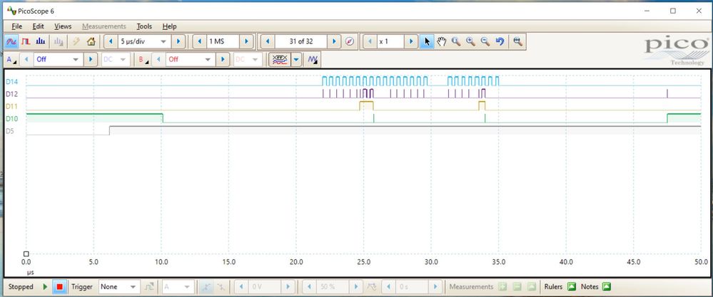

big gap between CS and SPI transmit
Options
‎2021-08-11 1:47 AM
// CS pin go low to select
HAL_GPIO_WritePin(GPIOB, GPIO_PIN_6, GPIO_PIN_RESET);
HAL_SPI_Transmit(&hspi1, (uint8_t *)spi_buf, 3, 10);
// CS pin go high to release
HAL_GPIO_WritePin(GPIOB, GPIO_PIN_6, GPIO_PIN_SET);
I use the above code to communicate with a device through SPI.
The green line D10 in the above picture is chip select (CS) signal. The gap between CS-enable and clock start is about 13 us, so is that between clock stop and CS-disable. It's too much waste of time. Anyone knows how to reduce it?

‎2021-08-11 2:08 AM
- The HAL hardware-abstraction-layer adds many instructions - checking that clocks are enabled, that function-call arguments are credible, locking access to peripherals so no other thread can interfere etc, before descending to LL low-level function calls. If you write registers directly (see the reference manual, and look at the source-code for the HAL function calls), things will be many times faster.
- You do not say how fast your processor is running. Increasing the system clock will increase the speed of HAL execution
- You do not say if you are compiling in debug or release mode. Debug is great for single-stepping, but it needs many more processor-instructions per line of code.
Hope this helps,
Danish
Options
‎2021-08-11 8:38 PM
- Do you mean this function HAL_StatusTypeDef HAL_SPI_Transmit? I will study it. I wonder if I use DMA, will make it faster?
- I am using stm32 nucleo f411re discovery board. Its HSE_VALUE is 25000000U.
- I changed debug to release mode. The timing did not change.
