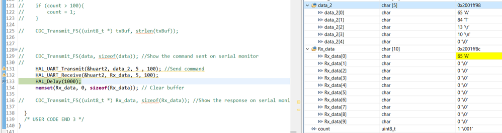

I figured out that the response of the ESP is much longer than just "OK\r\n".
The response is made up of two parts, 1) the line I just send , 2) the actually response.
So the response is "AT\r\r\nOK\r\n".
I had to use a bigger char array to store all the data.
    char data[] = "AT\r\n";
    char Rx_data[11]; //I expect the response OK: \r\nOK\r\n, six character + NUL
    HAL_UART_Transmit(&huart2, data, 4 , 100); //Send command
    HAL_UART_Receive(&huart2, Rx_data, 11, 1000);
Still I find this a bit strange. But maybe this is just the way it should work.
