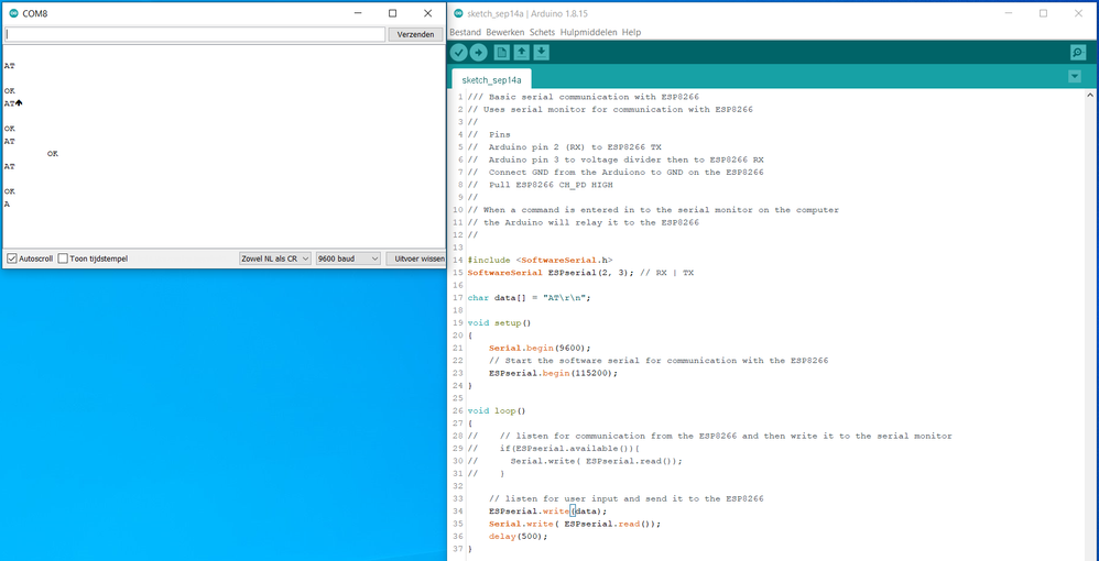

I made a example with the Arduino, this will send the AT command to the esp via UART and print the output. I want o get this working on the STM. If i understand how I implement this, I can make the HTTP requests.
