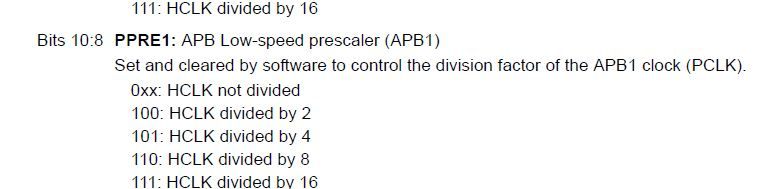

Hi all,
I've some problem with APB1, APB low speed prescaler setting. File stm32f30x.h of STM32F3-Discovery_FW_V1.1.0\Libraries, reports the below PPRE1 meaningin according with DM00043574 pg. 142:
#define RCC_CFGR_PPRE1_DIV1 ((uint32_t)0x00000000) /*!< HCLK not divided */
#define RCC_CFGR_PPRE1_DIV2 ((uint32_t)0x00000400) /*!< HCLK divided by 2 */
#define RCC_CFGR_PPRE1_DIV4 ((uint32_t)0x00000500) /*!< HCLK divided by 4 */
#define RCC_CFGR_PPRE1_DIV8 ((uint32_t)0x00000600) /*!< HCLK divided by 8 */
#define RCC_CFGR_PPRE1_DIV16 ((uint32_t)0x00000700) /*!< HCLK divided by 16 */
I've tried to set all the PPRE1 values in SetSysClock() and measured with my scope, and I see that: RCC_CFGR_PPRE1_DIV1 HCLK not divided RCC_CFGR_PPRE1_DIV2 HCLK not divided RCC_CFGR_PPRE1_DIV4 HCLK divided by 2 RCC_CFGR_PPRE1_DIV8 HCLK divided by 4 RCC_CFGR_PPRE1_DIV16 HCLK divided by 8 Have you aver seen the same behavior? #setsysclock #stm32-mco-clock-output

Radosław
Senior III
Posted on January 11, 2016 at 10:40
How your measurment look?
Probably you are doing something wrong.

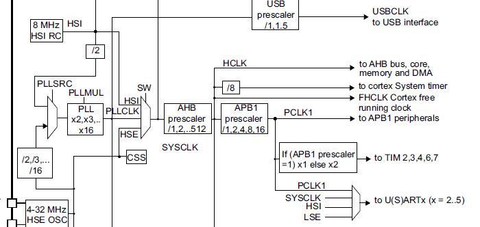

Posted on January 12, 2016 at 10:24
Thanks, You are rigth! I've simplified the code. I measure the PWM period of TIM3, and I see the same period with:
RCC->CFGR |= (uint32_t)RCC_CFGR_PPRE1_DIV1;
or
RCC->CFGR |= (uint32_t)RCC_CFGR_PPRE1_DIV2;
but I see double period with
RCC->CFGR |= (uint32_t)RCC_CFGR_PPRE1_DIV4;
quadruple with
RCC->CFGR |= (uint32_t)RCC_CFGR_PPRE1_DIV8;
Radosław
Senior III
Posted on January 12, 2016 at 11:04
Look to RM on picture with RCC structure.
If APB presc > 1 then TIM clk is multiply by 2.
andreaspiezia9
Posted on January 12, 2016 at 11:32
Here below the picture from DM00058181 pg 18:
as you said ''if (APB1 presc. = 1) x1 else x2. but this is in contrast with what I see:
APB1 presc = 1 or APB1 presc = 2 , TIM3_CLK is the same!
if APB1 presc = 4, TIM3_CLK double
Any way if you see RM0316 pg 142 it says different. What I'm doing wrong?
Radosław
Senior III
Posted on January 12, 2016 at 11:49
Consider AHB clk = 16Mhz
APB2_div = 1 -> TIM CLK = 16MHz
APB2_div = 2 -> TIM CLK = 16MHz
APB2_div = 4 -> TIM CLK = 8MHz
APB2_div = 8 -> TIM CLK = 4MHz.
andreaspiezia9
Posted on January 12, 2016 at 13:21
Thanks dembek, now it's clear!
APB1_div = 1 -> TIM CLK = (AHB/1)x1 = 16MHz
APB1_div = 2 -> TIM CLK = (AHB/2)x2 = 16MHz
APB1_div = 4 -> TIM CLK = (AHB/4)x2 = 8MHz
APB1_div = 8 -> TIM CLK = (AHB/8)x2 =  4MHz.
