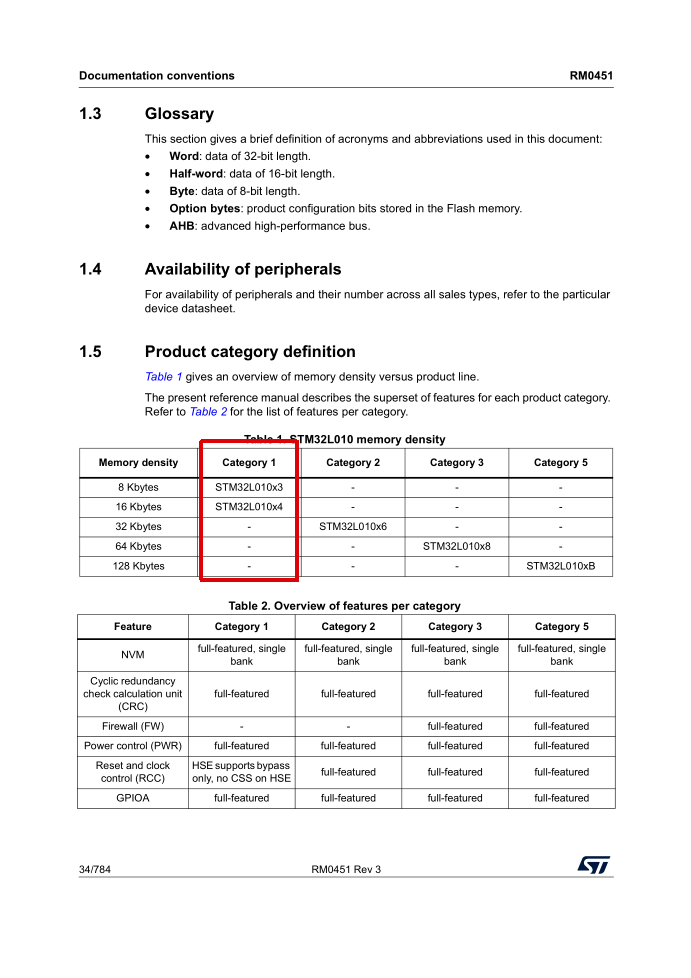

waclawek.jan
Divide and conquer: check whether DMA itself works, e.g. by observing its registers or by observing content of buffer in memory.
If DMA does not work, check if UART Rx works, again by observing its registers (note that that's intrusive for the overall working), and if does not work, check relevant GPIO.
If DMA does work, then follow the generic "interrupt does not fire" checklist.
All in all, it's just the usual "read out and check content of registers of all related modules".

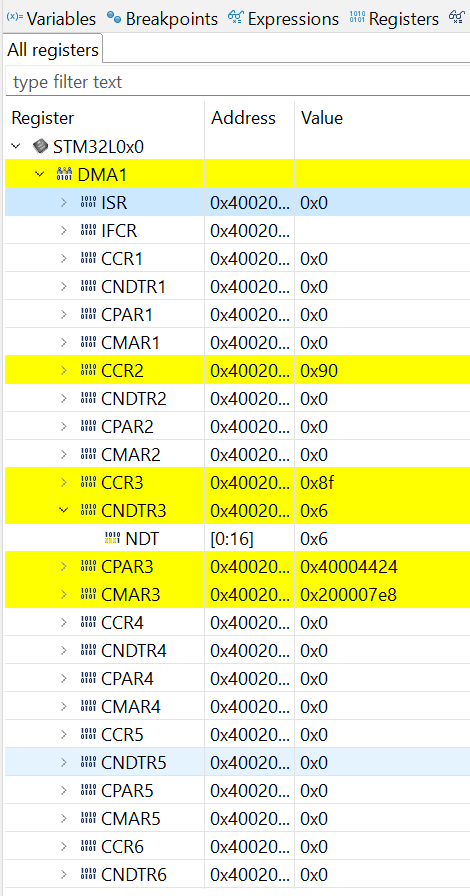

nobbyv77
UART works fine; can receive in interrupt mode (or polling mode). The DMA registers look correct per the datasheet (unless I'm missing something). CCR and CNDTR are set exactly as I'd expect:
From the "ISR does not fire" checklist:
1) Breakpoint is directly in ISR
2) Other ISRs (UART in interrupt mode) runs
3) No other interrupts are enabled (besides UART and sys tick)
4) Interrupt is enabled at source
waclawek.jan
Pity you didn't show the DMA_CSELR register too.
When data arrive, does CNDTR decrement? When 3 bytes arrive, is the respective HT flag in DMA_ISR set? Doesn't interrupt end up in some default interrupt handler (i.e. is the ISR's address inserted at correct position in vector table?)

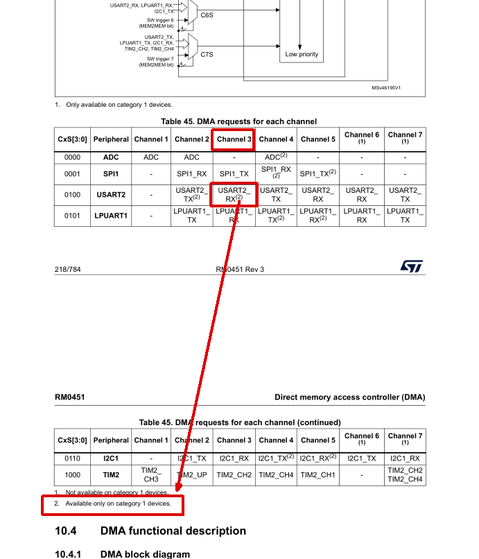

It dawned to me.
* Which* STM32L010 ?
They are NOT created equal!
_legacyfs_online_stmicro_images_0693W00000biVoSQAU.pngJW
nobbyv77
Good thought, but using STM32L010F4P6.
Try the Channel 5 plumbing
If it's not triggering trace the plumbing through the DMA's mux, back to the USART
