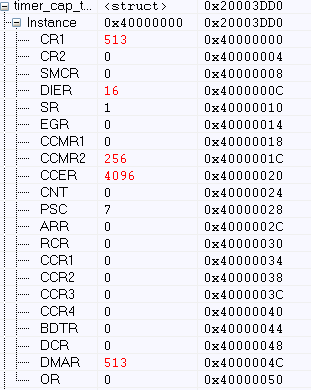

Why I am not having any interrupt? My registers value after set_callback function is next:
Which seems to be OK. So, what's the matter? Why I'm not getting any interrupt?
