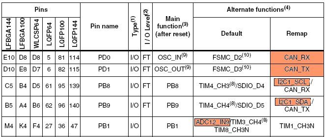

1.- how does the micro
distinguish I2C1_SCL and USART_TX
1.
The peripherial that is enabled takes control over the pins. Simply do not enable another peripherial on the same pins.
2.- And if my I2C_SCL and I2C_SDA pins are PB8 and PB9, how must I configure it??
You will have to remap the I2C1 pins to PB8/9:
  GPIO_PinRemapConfig(GPIO_Remap_I2C1, ENABLE);

So to use the remap colum of one pin we must do:
and only with that the pins PB8 and PB9 gets configured??
Must we configure the pin PB8 and PB9 like alternate function??
So to configure:
PB8 = I2C1_SCL
PB9 = I2C1_SDA
PD0 = CAN_RX
PD1 = CAN_TX
PB1 = ADC12_IN9
Is the following code correct?
ONLY PINS CONFIGURATION
GPIO_InitStructure.GPIO_Speed = GPIO_Speed_50MHz;
/*--------------------------------------------------------------------------------- PD.0 / PD.1-------- */
GPIO_PinRemapConfig(GPIO_Remap1_CAN,ENABLE); // THAT OR THE FOLLOWING?
GPIO_PinRemapConfig(GPIO_Remap2_CAN,ENABLE);
/* --- Configure CAN pin: RX ---------------- */
GPIO_InitStructure.GPIO_Pin = GPIO_Pin_0;
  GPIO_InitStructure.GPIO_Mode = GPIO_Mode_IPU;
  GPIO_Init(GPIOD, &GPIO_InitStructure);
/* --- Configure CAN pin: TX ---------------- */
  GPIO_InitStructure.GPIO_Pin = GPIO_Pin_1;
  GPIO_InitStructure.GPIO_Mode = GPIO_Mode_AF_PP;
/*--------------------------------------------------------------------------------- PB.0 / PB.09 -------- */
GPIO_PinRemapConfig(GPIO_Remap_I2C1,ENABLE);
 GPIO_InitStructure.GPIO_Pin =  GPIO_Pin_8 | GPIO_Pin_9;
  GPIO_InitStructure.GPIO_Mode = GPIO_Mode_AF_OD;
  GPIO_Init(GPIOB, &GPIO_InitStructure);
/*----------------------------------------------------------------------------------------------- PB.01 ----- */
GPIO_InitStructure.GPIO_Pin = GPIO_Pin_1;           /* PB.01 ADC CHANNEL 9 */
  GPIO_InitStructure.GPIO_Mode = GPIO_Mode_AIN;       /* ANALOG INPUT */
  GPIO_Init(GPIOC, &GPIO_InitStructure);
FOLLOW THE NEXT FIGURE

If you want to use a port pin for alternate function, you
always
have to configure it:
* For peripherial outputs (like Usart TX, SPI CLK)  normally AF_PP or AF_OD must be used. This disconnects the pin driver from the GPIO and connects it to the peripherial
* For inputs (e.g. RX, SPI MISO) normally IN_FLOATING, sometimes IPU/IPD is required. (BTW: This means that reading the state of the GPIO pin is still possible)
Chapter 8.1.11 in the Useguide shows the configuration for every peripherial. (you will find I2C listed with AF_OD there)
With remapping, you simply route the peripherial lines to another port. Sometimes you have more than one choice. CAN is initially found on PA11/12 and might go to PB8/9 or PD0/1 when remapped. This is the reason why GPIO_Remap1_CAN (for PB8/9) and GPIO_Remap2_CAN (for PD0/1) exist.
And to make things even more complicated, some peripherials can be partially remapped...
