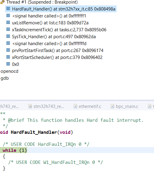

after using flash functions for flash write code is jumping into hardfault handler
Anand Ram
my code is jumping into hardfault handler 0693W000008xrWeQAI.pngduring/after flash write procedure.some problem with mutex or task handling,
can somebody explains how to hold the thread until the flash write is complete.
note: flash write functions are called inside the "below normal " priority thread.

hi, i have fixed this issue,
there is problem in flashing of 96 K in 5 millisecond task, and other tasks are halt and ended with trap.
I have implemented a semaphore concept to flash block by block and the task un-interruption is solved.

can we see your "flash function" ?
Are you erasing flash pages before writting them?
Also, there is a lock unlock flash logic you should pay attention to.

_disable_irq();
 do{
  sl_ret = BPC_FLASH_Block_Erase_l(FLASH_BANK_SECTOR_6, FLASH_BANK_2, ERASE_SECTOR_PARAM);
 }while(sl_ret!=B_TRUE);
 osDelay(2000);
 BPC_FLASH_FlashWrite_l(&infoBlock1,pccom_adr_flash, (U_INT8 *)pccom_adr_ram, laenge_long);
 __enable_irq();
but i guess , since i copy 96 kb of data from RAM to flash during write leads to thread lock and then causes systick exception with hardfault handler
i dont have experience about your specific setup but isnt disable_irq() dissabling your RTOS scheduler?
and maybe breaking something else?

To add to what Javier already said... Why are you disabling interrupts at all? Why is there a delay function? Have you read the FLASH section in the reference manual and understand how it works?
