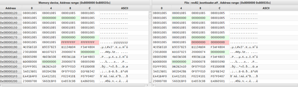

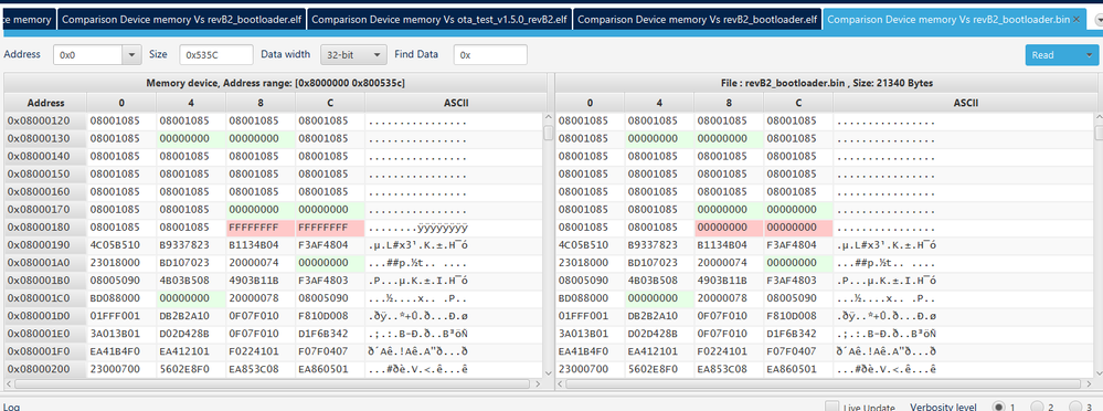

I am writing a bootloader and I experienced that the calculated CRC on the binary is different If I load the fw with cube IDE versus cube programmer. I use STM32F405.
This happens too if I make the compairement on the bootloader programme too.
The difference is present on 8 bytes after the interrupt vector table.
For example in this case: (based on the .map file's information)
- the bootloader programme starts at 0x800.0000 and
- the .isr_vector is 392 byte length which is 0x188.
- the .text region starts at 0x800.0190
- So memory 0x800.0188-0x800.018F is unused if i seems well.
I attach the screenshots of these compairements in cube programmer.
The difference is independent of whether I compare the mcu with the .elf or the .bin file.
If I load the programme with the cube programmer, the difference disappears.
I do not know why there is the difference. Could anybody tell me?

I made a comparison the in the case of the bootloader.bin file, and I found the same problem. Now I examine the bootloader, because it produces the same problem and it is simpler.

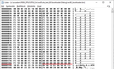

- In the .bin files the unused 8 bytes after the interrupt vector table are filled with 0.
I attach an image from this .bin file which made with a hex editor.
The bootloader is aligned to 0x800.0000 so it is quite sure aligned.
When I programmed the flash from the CUBE IDE the CRC did not match. After this I read out the flash of the mcu with the cude programmer and there I found these 8 bytes are filled with 0xff. 0xff is the values after the flash has been cleared. So this made the difference in the CRC.
I think the IDE uses the .elf file for programming instead of .bin.
