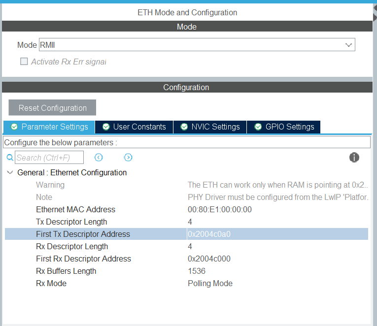

We have custom board based on STM32F745VGT6 having Ethernet peripheral over RMII mode.
Previously with the older version of Cube MX and Library our Ethernet was working, after the new update of library there are some major changes in the library and now it is not working i.e. we are unable to ping the board.
We tried to follow the example of H7 but there was not positive result.
If someone has working example or has reference for F7 it would be grateful.
If something from out project is required (configuration), please do let me know.

Hi @STea,
Yes, you are right we are using LWIP and after update of tools we are unable to have functional Ethernet.
Cube Firmware Version : 1.17.1 (STM32Cube FW_F7 V1.17.1)
Also we are not directly implementing this in our application, we have created a new project only to check Ethernet.
I verified the pin connection and they seems to be correct.
To be specific i am talking about ST's Ethernet driver update (library).
I have also tried the example link provided, but it didn't gave any positive result.
Below is the configurations used in my project.

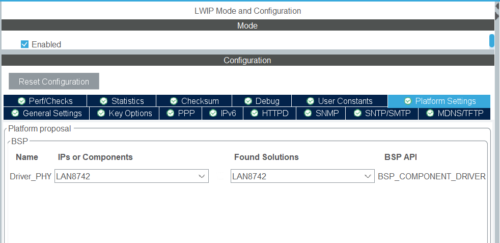

NOTE: I am using Ehternet SWITCH and not PHY.
Configuration of the project:

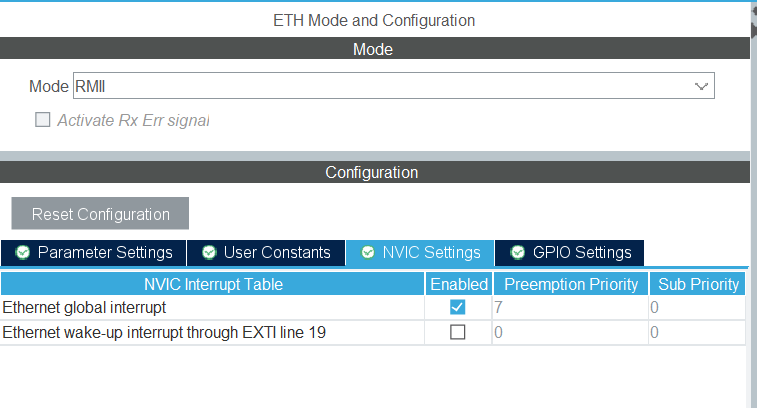

Ethernet Configuration - 1Ethernet Configuration - 1
Ethernet Configuration - 2Ethernet Configuration - 2

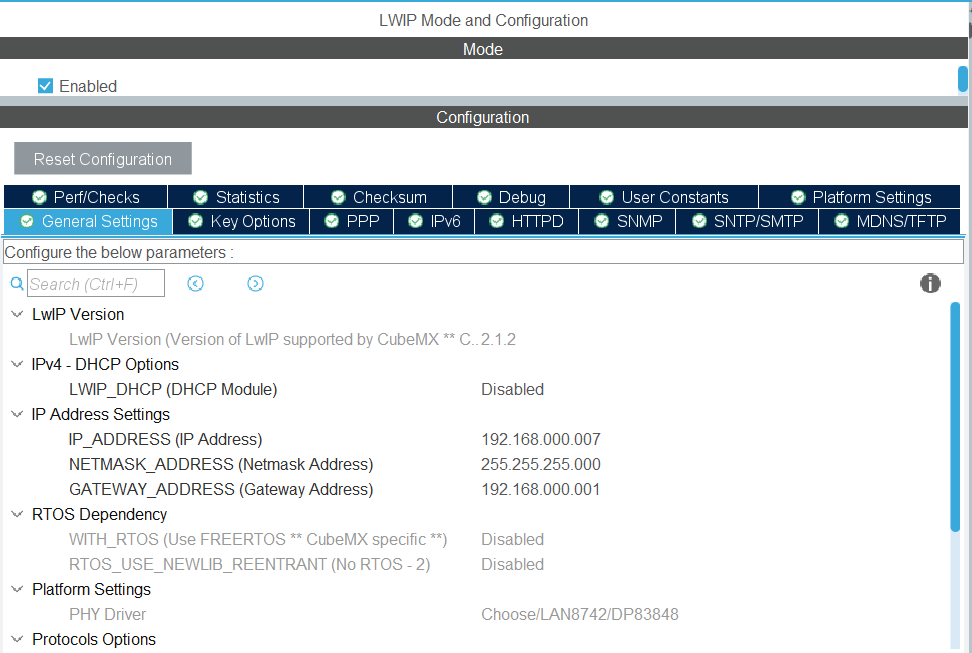

LWIP Configuration - 1LWIP Configuration - 1
LWIP Configuration - 2LWIP Configuration - 2
 /*Memory configuration in STM32F745VGTX_FLASH.ld*/
MEMORY
RAM (xrw) : ORIGIN = 0x20000000, LENGTH = 320K
FLASH (rx) : ORIGIN = 0x8000000, LENGTH = 1024K
Memory_B1(xrw) : ORIGIN = 0x2004C000, LENGTH = 0xA0
Memory_B2(xrw) : ORIGIN = 0x2004C0A0, LENGTH = 0xA0
.RxDecripSection (NOLOAD) : { *(.RxDescripSection) } >Memory_B1
.TxDescripSection (NOLOAD) : { *(.TxDescripSection) } >Memory_B2
