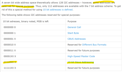

Note that 0x7B is a reserved address and isn't a valid 7-bit address. Perhaps the chip you are interfacing with is set up for 10-bit addresses. In which case you should send the second byte of the 10-bit address in response to the ADD10 flag.
Addressing - I2C Bus
It's not clear if setting ADDMODE bit is required to start 10-bit addressing, or if sending the header 0b11110xxx initiates 10-bit address mode as a master. My guess from reading the RM is the latter.
