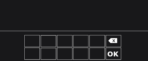

Hi, I've created a custom keyboard and so far all works good. I've just a problem: I want to use an OK button on the keyboard to copy the text edited to a text area in an other screen. I'm able to go to the other screen but when i do the second part of my goal, I've got errors. I think the problem is in the function getBuffer.

This is my keyboard:0693W000005BHAKQA4.png

As the error mentions, CustomKeyboard::getBuffer() is undefined. It is because CustomKeyboard does not have the getBuffer() function. It's the Keyboard class that has it, not CustomKeyboard ;) CustomKeyboard does not inherit from the Keyboard class but only has a Keyboard object as an attribute.
So you need to define a getBuffer() function in your CustomKeyboard class to be able to call it from your ScreenView.
Something like :
Unicode::UnicodeChar* CustomKeyboard::getBuffer()
  return keyboard.getBuffer();
Don't forget to declare it in the .hpp file as well.
The fact that both your CustomKeyboard and Keyboard variable have the same name is misleading. I suggest you to change your CustomKeyboard variable name to customKeyboard to avoid mixing them.

The error is the following:
TouchGFX/build/STM32F746-DISCO/TouchGFX/gui/src/screen02_00_screen/Screen02_00View.o: In function `Screen02_00View::getBuffer()':
   /TouchGFX/gui/src/screen02_00_screen/Screen02_00View.cpp:28: undefined reference to `CustomKeyboard::getBuffer()'
Something like :
