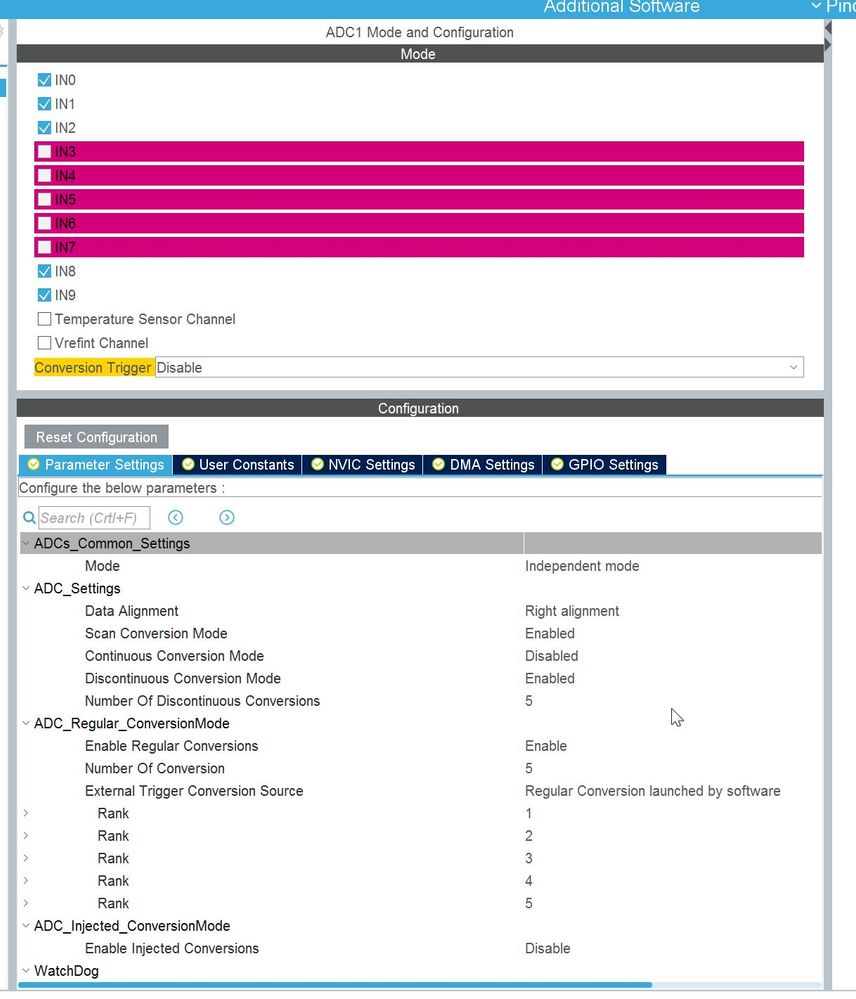

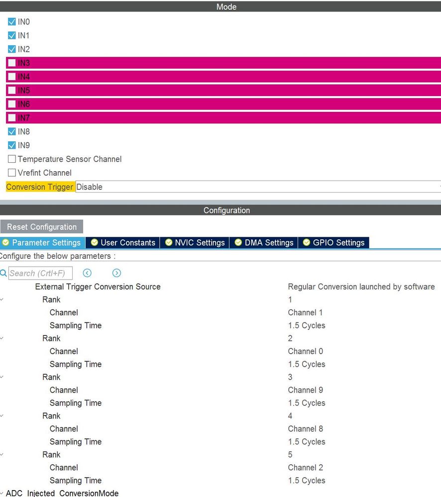

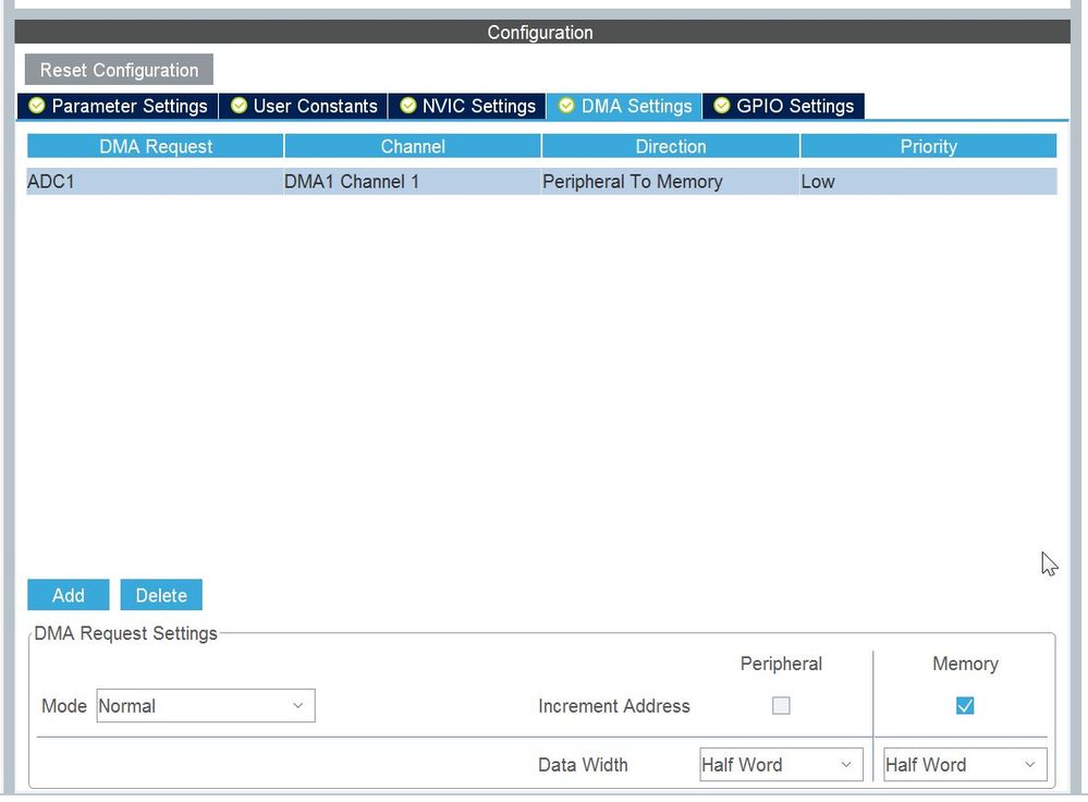

I want to use an ADC with DMA in a STM32F103. I configured it in Cube as you can see in the following picures.
When I start the conversion with
HAL_ADC_Start_DMA(&hadc1,(uint32_t*)AdcData,5);
HAL_ADC_ConvCpltCallback() is called and I see that the AdcData values all changed.
Unfortunately the first rank is sampled twice and the last rank is lost.
I tried to extend the DMA length to 6 but then I do not receive the callback.
I tried to extend the DMA length to 4 but then the last AdcData is unchanged.
Has anybody an idea why this happens and how I can get rid of this?

Now I found out that the false ADC conversion is triggered by setting the DMA bit when it is already set. Somehow the HAL does not clear this bit at the end of conversion.
I added
hadc1.Instance->CR2 &= ~ADC_CR2_DMA;
to my code after the conversion finished and now it works as expected.
But this is not a good solution.
EDIT:
I now searched for the ADC_CR2_DMA bi in the HAL source file and found
CLEAR_BIT(hadc->Instance->CR2, ADC_CR2_DMA);
only in HAL_ADC_Stop_DMA();
So I have to call HAL_ADC_Stop_DMA() before I can call HAL_ADC_Start_DMA() again?
EDIT:
Nope, calling HAL_ADC_Stop_DMA() causes a DMA_ERROR since the transfer finished already regularly.
Calling HAL_ADC_Init() does not solve this problem either. It does not clear the DMA flag.
So, STM, please review this issue for purpose..

Discontinuous mode is intended to convert a subgroup of the sequence defined in ADC_SQRx. But you set DISCNUM to the same value as ADC_SQR1.L. That doesn't make sense, so just simply don't set DISCEN.
