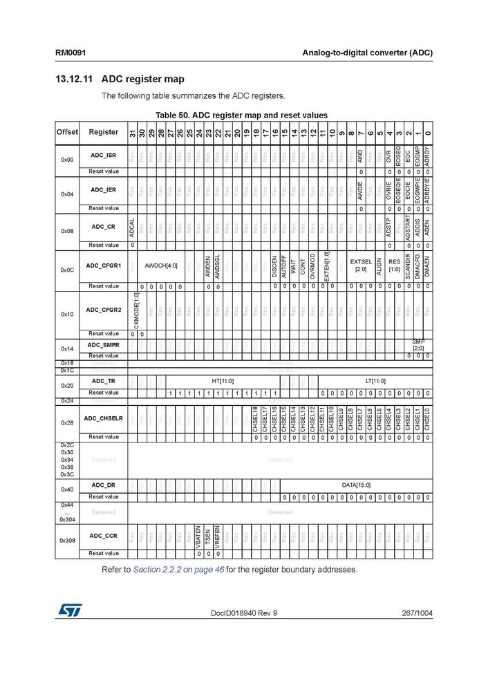

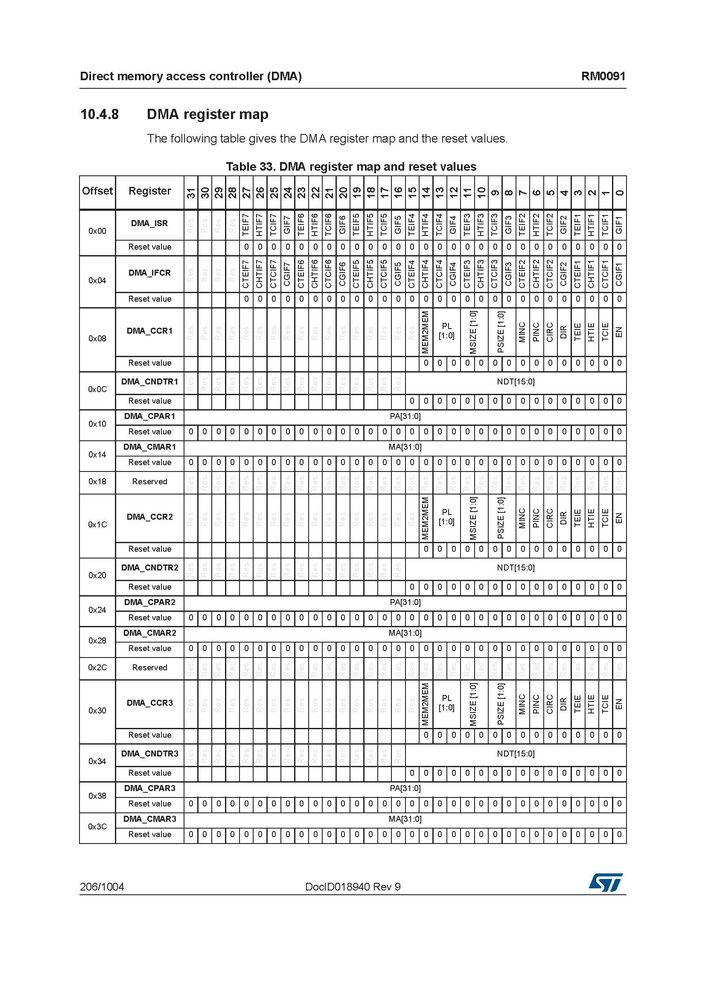

stm32f091
Do you mean ADC and DMA register map?0693W000001cIA4QAM.jpg0693W000001cI9vQAE.jpg
berendi
Principal
I mean the contents of the registers. Then it would be possible to check them against the pages preceding the ones that you have posted.
