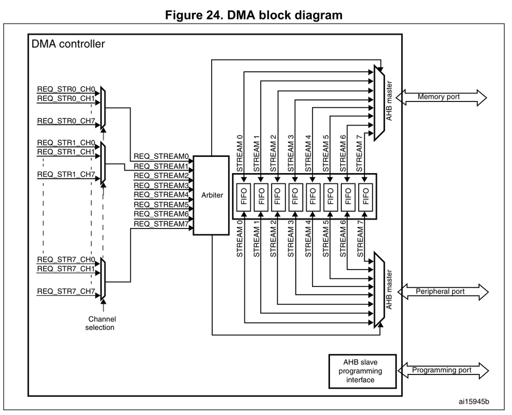

Hi everyone,
ı was trying to make adc to dac using DMA. Shortly the adc value is writed into DAC data register. So that the potentiometer is turned then the digital value is writed ADC register. The brightness of led is changed. However, ı get ADC value via DMA then ı writed into DAC register and nothing happened. I did the project without DMA and it worked as what ı want. How can ı do that using DMA. In my solutions are multi DMA, triger event. Also, the ADC channel to pin A0 and DAC pin to A4. Do you have any idea ?

If I understand posred diagram correctly, F4 is not capable to make peripheral-peripheral transaction, there is no switch to routing. Simple solution is to create a buffer in memory, than configure one dma stream adc-mem and another mem-dac, both poited to the same mem buffer.
December 28, 2023
Due two different direction (peripheral to memory and memory to peripheral), Do ı point the memory of buffer
DMA2_Streamx->M0AR &buffer for DMA1 and DMA2 or one of them must be DMA2_Streamx->PAR &buffer ?
Also, do ı need to point data alignment register for DMA1 and DMA2 for example DMA2_Streamx->PAR &DAC->DHR12R1
