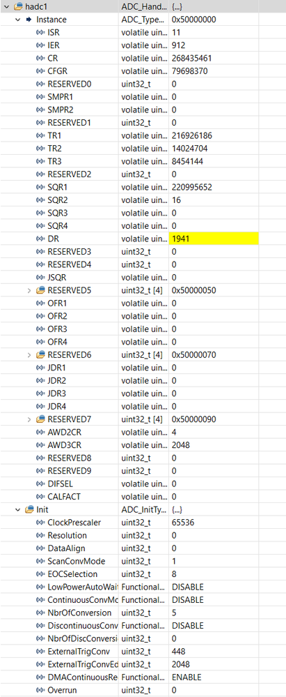

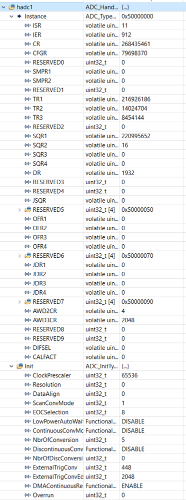

I am using the ADC with the DMA. I developed that feature and tested and everything looked alright. I have been developing some more over that and I see that after startup the values are correct but after a few ms the read values are not correct and in the checked cases, above the expected value.
I have seen that changing totally unrelated parts of code affect this issue happening or not. Changing the compiler optimization also affected whether the issue happens or not.
Browsing around I found an article discussing the usage of the volatile keyword on variables tied to hardware, like the DMA buffer and using the volatile keyword in that buffer made it look like it was the solution as adding or removing the change allowed for repeatable tests where the issue was happening or not, and I moved on. A few unrelated changes later, the issue is back. Do you have any suggestion of what should I check or what is the reason?
In addition, find attached the a picture with the ADC object before and after crashing.

2020-05-14 4:51 AM
ST support helped me troubleshoot the issue and it was due to a high DMA usage which was solved by increasing the S/H times of the ADC. In my case I went from 1.5 cycles to 19.5 and that made it.
