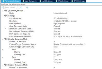

I am using STM32F423RHT6 in my project. I am using 2 ADC Channels for measuring Voltage and Current(through Current Sensor). But I am facing a strange issue. Where the channel corresponding to the current is getting accurate values of analog voltage. The issue arises when I measure ADC value corresponding to voltage. I am using a voltage divider to measure the values of voltage ranging from 83.5V to 70.0V. The values are within 3.3V.
Issues facing:
1.
The value of voltage when measuring across the multimeter is say 2.45V, but in conversion of digital to analog value, I am getting voltages more than 2.45. I am getting around 2.6/2.7.
2.
When I am Probing across the voltage divider using a multimeter, this ADC input voltage corresponding to the voltage divider is getting reduced. Which is why, if we don't probe, causing the issue number 1 which is more voltage.
NOTE:
Probing through the multimeter doesn't affect the current channel but only the voltage channel.
3.
When I simultaneously read from both the channels, the channel corresponding to the current is accurate and the value of the voltage channel is getting increased and unable to find the relation between V and I to map the voltage and current.
What might be the issue?
I am using ADC in DMA mode to read the ADC Values. Have taken the pin outs of ADC separately and have connected it to Gnd and Vcc to check if they are independently working or not. They are working with this scenario independently but when connecting to Voltage divider and Current sensor, again the same issue. Tried with a different channel but the ADC Pin concerning voltage divider face the issue of overvoltage during normal cases and undervoltage when probing. This is a hardware issue but don't know how to proceed further.
Kindly reply if anyone has a solution!

80M resisstors as input impedance into ADC require veeery long ADC time and result isnt predictable.
