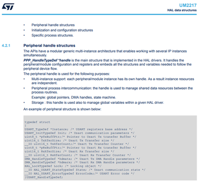

UM2217: User Manual - Description of STM32H7 HAL and low-layer drivers:
https://www.st.com/resource/en/user_manual/um2217-description-of-stm32h7-hal-and-lowlayer-drivers-stmicroelectronics.pdf

This is for situations where ONE callback routine needs to determine which handle/instance is being referred too.
ie &hadc1 or &hadc2
If those were your instances / objects.
As a pointer, you could perhaps override them and use a structure that carries ST's information and your own. Say buffers associated with the ADC1 instance, rather than use globals for everything.
This is really so you don't have to pass dozens of common parameters around, and the code scales cleanly if you need to manage 2x, 3x or 10x ADC peripherals.
