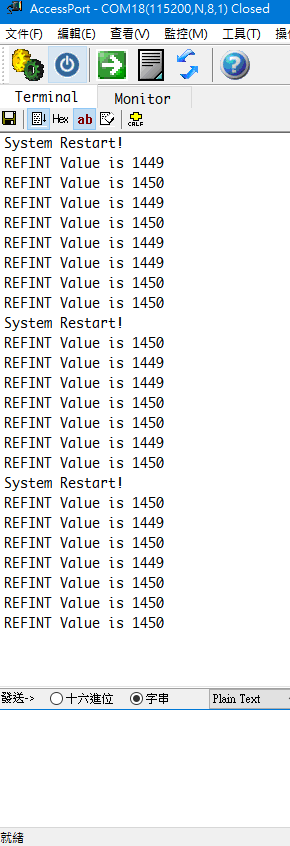

I just use CubeMX and nucleo stm32F303 to make a quick check.
SystemClock_Config();
MX_GPIO_Init();
MX_USART2_UART_Init(); MX_ADC1_Init(); printf(''System Restart!\r\n'');while (1)
{ HAL_ADC_Start(&hadc1);HAL_ADC_PollForConversion(&hadc1, 20);
adcResult = HAL_ADC_GetValue(&hadc1);
printf(''VREFINT Value is %d\r\n'', adcResult);
HAL_Delay(500);
}It seems okay without the strange result you've described. (I use the onbard reset button.)
