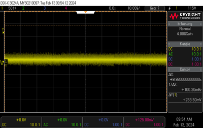

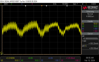

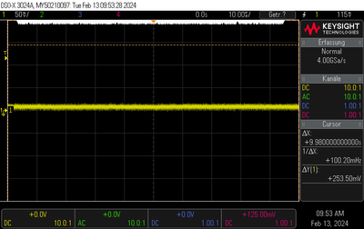

‎2024-02-13 1:23 AM
Hello AScha.3,
i like the idea, to measure the voltage of the pin, when it is configured as output, for checking the internal power rail of the GPIO Peripheral.
Compare GPIO driven LOW - without and with FMC-Active:
vs.
Compare GPIO driven HIGH - without and with FMC-Active:
vs.
noise is in both cases definitely more than nothing. The 3V3-supply-ripple, the noise on the pin and the noise on the power-rails in sum is with sure not that far away from the 200mV Hysteresis of the GPIO-Pin. Most of the noise effects the chip internally, so i think, with better filtering, or better layout you can't reach a really safe design with this mcu as long as the schmitt trigger hysteresis is that low.
You are right, that the 0.3 to 0.7xVDD (in my case 3.3V * .4 = 1,3V) - undefined area for digital pins is much higher the the 200mV Hysteresis, but if this sum of noise is the problem of this/my issue, wouldn't it be better to have higher Schmitt Trigger hysteresis (e.g. 500mV or even more)? Why isn't it designed higher?
I have never paid so much attention to a GPIO evaluation as I did with ST now. And I didn't need it either.

Hi @AZorn.1 ,
I see about 10mVss + 50mVss with FMC on gnd ; i am little bit surprised - i expected more. :)
Is cpu setup with slow/medium pin speed or hi ..? Would be interesting, to see "gnd " with highest pin speed , to compare effect.
btw Where is this 30kHz ripple on vdd coming from? smps supply ?
Which pin/port is tested ? + on which group is FMC ?
Because cpu internal ground is not same on all digital ports + analog group (just guessing here).
Maybe @STOne-32 could tell us about internal ground - if he likes...

‎2024-02-13 2:09 AM
- this scopes are done on the original FMC setting with 133MHz and highest pin-speed.
- 30KHz ripple is from SMPS-supply,
- one of the affected pin is PB12 (on which i did de scopes above)

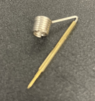

Just to make sure:
scope measurements are done without the ~10cm GND clip, but with the ground / spring / tip directly besides the "hot" contact?
‎2024-02-13 3:50 AM
@LCEyes, with the spring-tip, to have GND loop as small as possible.
:thumbs_up:
‎2024-02-13 4:30 AM
Ah, spring-tip is the official name? Never used that in english... :grinning_face_with_sweat:

‎2024-02-13 8:38 AM - edited ‎2024-02-13 8:39 AM
sorry for my partially google-translated way of writing here.
What would you name this item:
‎2024-02-13 8:43 AM
I was rather laughing about myself, I think "spring-tip" is pretty good.
I would call it "Probe-Kontakt-Feder", beautiful "Denglisch". ;)
