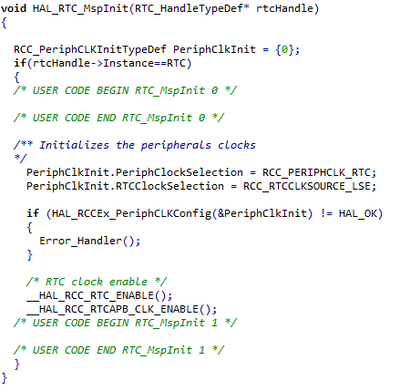

    /* USER CODE END RTC_Init 2 */
Stassen.C
J_m,
That should do it, just check that in the HAL_RTC_MspInit the clock selection is also LSE.
Regards,
Stassen
j_m
Thank you very much.
I can confirm that the RTC is updated.
