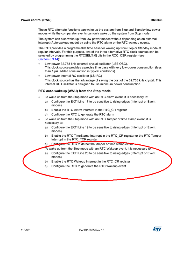

If you have debugger connected, the processor core continues to run, consuming power, see DBGMCU_CR.
For wakeup, make sure you follow all these steps:
0693W00000NpvQZQAZ.pngi.e. read out and check all relevant RTC and EXTI registers content.

RTC wake-up EXTI line 20 is Enabled.
RTC CR->WUTIE setted
RTC CR->WUTE setted
But not works...
And RTC Wake-up configured time to to wake-up by HAL_RTCEx_SetWakeUpTimer_IT

waclawek.jan
May 13, 2022
> If debugger connected power 960uA, after disconnect debugger - 810uA, bot not 2..10uA
Did you power-reset after disconnecting debugger?
It's irrelevant that you've used some "library" function - since you've used it, it's part of your code thus your responsibility. Cube/HAL is open source so you can look at it, and you can check the registers content it changes.
Does the wakeup interrupt work without going to sleep?
