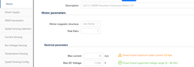

I'm working on a BLDC motor control project using the X-NUCLEO-IHM07M1 driver board with a NUCLEO-F446RE. I'm trying to control an A2212-13T BLDC motor (1000KV) with a 12V power supply at 2.5A, and targeting around 5000 RPM, but the motor does not spin at all.
I have confirmed that the jumper settings on the X-NUCLEO-IHM07M1 are set correctly for 3-shunt operation, and the firmware is properly loaded using STM's MCSDK.

Hello @Duc,
According to the A2212 Motor data sheet "Max Efficiency Current: 4 - 10A" and the maximum current is 13A.

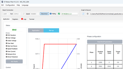

X-NUCLEO-IHM07M1 board is limited to 2.8A (40A for B-G431B-ESC1) as mentioned at project configuration step, as then not appropriate for this motor.
I assume that you have Driver Protection error, isn't it?! Decreasing Torque Target to 0.8A, I am able to start the motor and reach 5000 RPM.

Thank you again for your helpful suggestion! I made the adjustment to the Torque Target to 0.8A as you recommended, and the motor spun up as expected, reaching around 5000 RPM. However, I realized I missed an important point in my original post.
When I attempted to use the profiler to estimate the motor parameters, I found that the A2212 motor already has parameters in the Motor SDK, which I wanted to test with both the X-NUCLEO-IHM07M1 and B-G431B-ESC1. While the B-G431B-ESC1 worked perfectly, I’m still facing issues with the X-NUCLEO-IHM07M1—specifically, the same behavior as mentioned in my original question, where the motor doesn’t spin.
Could the current limitation on the X-NUCLEO-IHM07M1 (2.8A) be causing issues with running the motor profiler, or is there another factor preventing the profiler from working as expected on this board?

Hello @Duc,
As specified on A2212 Motor datasheet "Max Efficiency Current: 4 - 10A". These values are achievable with B-G431B-ESC1 and not by X-NUCLEO-IHM07M1.
If you agree with the answer, please accept it by clicking on 'Accept as solution'.
