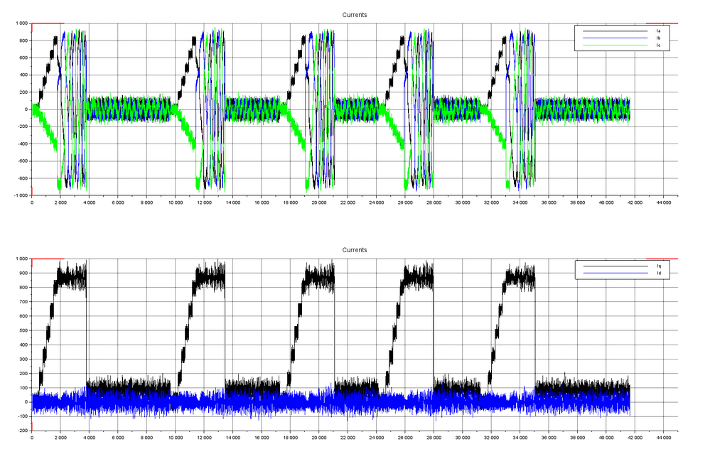

Here is a screen shot of the current measured with version X :
The plots represent 5 sequences of start stop. Each sequence is composed of two parts, one open loop start that consumes more current and a small current as soon as the observer takes the control.

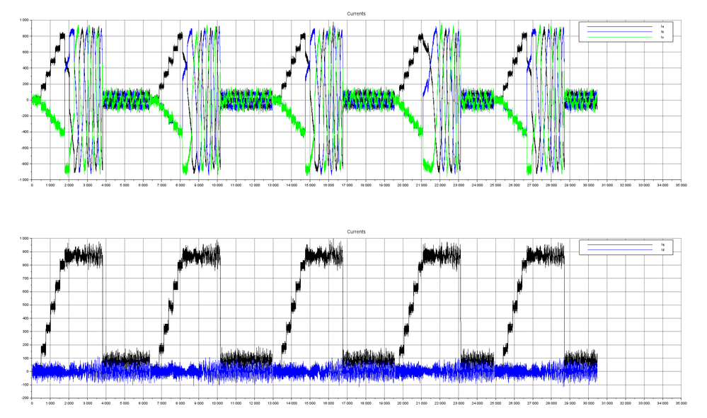

Here is the same measurement done with version Y:
Both versions produce very similar results.
Could you tell us a bit more about your software environment. Do you use the motorcontrol SDK, if yes which version ?
You mentioned a call to HAL_TIM_PWM_start && HAL_TIMex_PWM_start, but those functions are not part of the SDK delivery.
