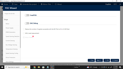

why motor profiler option not coming while setting parameter in workbench
poonamlakhara
 i m using customized stspin32g4ACT board , nd version of work bench m using is 6.3.1 but when i try to generate code there is motor profiler option is disable  although m using stm32ide 1.17.0 when i upload code for led blink using pc14 it turn but don't blink but when m upload code through Arduino it blink very good pc14 and pc13 both in st32ide it does not blink show suggest me where i lacking motor m using is 2 pole hall sensor code is blow  , i m new to workbench so pls guys guide me
nd this is disable motor profiler image

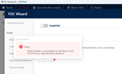

GMA
Hello @poonamlakhara,
Positioning the cursor on red bullet, you will have the explanation
Check LED_2 definitions LED_2_GPIO_Port and LED_2_Pin: GPIOC and GPIO_PIN_13. Does LED_2 blink "USER" button?
If you agree with the answer, please accept it by clicking on 'Accept as solution'.
