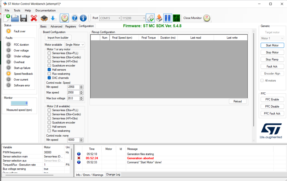

Hi, I'm not seeing the 5 revup configuration slots I should be seeing? It was fine the first time I did this.

Dear Popeye,
Firstly, we would like to sincerely apologize for the delay in replying to your post.
It is normal if you are using Hall Sensors.  As mentioned in UM2392 FW User manual, "a rev up phase may be needed that will take over that process until the rotor Position estimation is judged reliable". It is not needed as Sensor will give the absolute shaft position.
