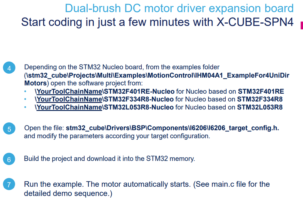

Where is the example project for X-NUCLEO-IHM04A1 on NUCLEO-F303RE?
Aalbo.1
Hello, I'm trying to control motors with the X-NUCLEO-IHM04A1 connected to the NUCLEO-F303RE.
In the instructions that I found on the ST website they say to "open the software project from the example folder". Where is the example folder?

Hello @Aalbo.1​,
The example is provided within the X-CUBE-SPN4 cube package, just download it and follow the path mentioned in the description:
..\STM32CubeExpansion_SPN4_VX.XX\Projects\Multi\Examples\MotionControl\IHM04A1_ExampleFor4UniDirMotors .
Chahinez.
