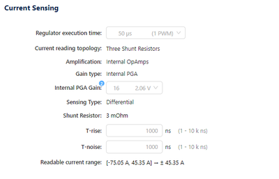

Yet, on WB view, I got these  :
I'm working on a custom Inverter with a STM32G431RTBx and all the other features show up well.

SingleShunt_AmplifiedCurrents_noOffset is dedicated to 6-steps because the current sampled is always positive.
Regarding the OverCurrent protection, may I ask you what is your driver? Most of the time drivers have a Fault signal that is use in the MCSDK for the Driver Protection feature. Your Hardware Variant makes use of raw currents, it means non-amplified current ( connected directly from the shunt). I guess it is not your use case.

- I want to use 6-steps only. MCU used is a STM32G431RBT6 (which is compatible with FOC and 6-steps). I am not starting from a ST board  but I'm using them as examples to build my controller's board description.
The driver used is DRV8350RSRGZR but  we want the software to be as driver-independent as possible, as the driver may change in the near future and it already has two single-shunt (redundant) current measurements in place.
You are right ! We do not use raw current ! We have two amplified current input. I want to use one for current sensing, and the other for overcurrent potection with a internal comparator and internal generated reference (as we do in our proprietary software). The two currents  inputs have the same amplification ratio. Maybe this is impossible with the workbench ?
