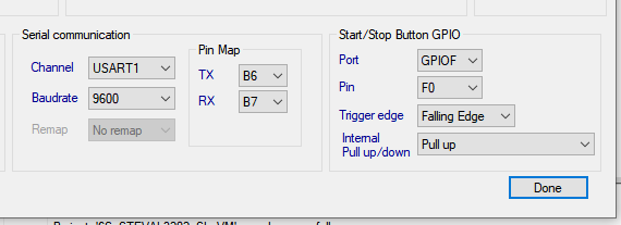

I am unable to establish UART communication between ST MotorPilot and STEVAL-SPIN3202.
I am uploading one of the two STEVAL-SPIN3202 examples.
Setting up 9600 baud rate (same as in Cube MX settings). Using correct COM port.
Hardware setup:
Power 24VDC connected.
USB connected.
J9: OPEN (BOOT0). (closing does not do any change)

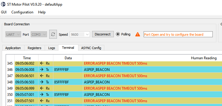

I am trying to connect with ST MotorPilot - result:

0693W00000KaAmgQAF.png0693W00000KaAnyQAF.pngit does not blink red/green USB LEDS and result is the same, no matter whether If close J9 or not and reset the MCU.
Result is the same, :
What am I doing wrong?

May I ask a question, did you check on workbench interface if UART IP is available (digital i/o box)?
In the example below, it is not available...
0693W00000KaZe3QAF.pngIf it is the case, I assume that you are using a WB5.Y. if yes, could you try with WB5.4.8 please?

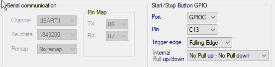

EShaw.1
Hi GMA,
Thank you for the answer.
I ran WB4.5.8
0693W00000Kaa09QAB.pngNow UART is active.

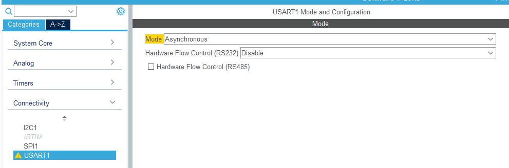

I am not sure where I can find  UART IP  (digital i/o box) on Workbench interface.
In MX, Hardware control is disable by default.

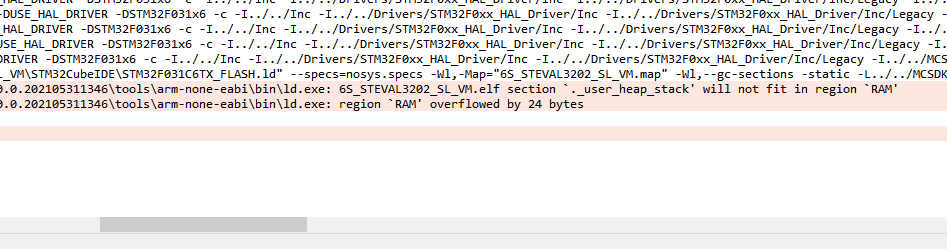

After attempt to copmpile and run:
It does not fit to RAM by 24 bytes.
How can I fix this?

GMA
Could you try using "LL - Low Level" for "Drive Type" on Project generation option?

EShaw.1
Hi GMA,
Thank you very much!
I changed the Drive Type as you suggested.
Now UART communication with Monitor works.

Mr. K
Had this same problem today. To recap for others when using STEVAL-SPIN3202:
  • MCSDK-Y's Motor Pilot does not work with the SPIN3202 even though is shown as an option. You need to use MCSDK 5.4.8 and its Motor Monitor utility.
  • Drive type needs to be "Low Level" when generating/updating in MC WB. HAL is too large even when using code optimization.
