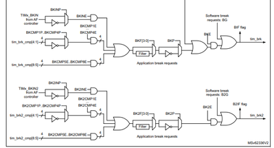

Dear All,
I am currently configuring the break function of TIM1 on the STM32H5. Does anyone know the difference between these two polarity settings?
(I am unable to distinguish between these two settings. If I set one to high and the other to low, is the actual fault signal active low or high?)
    1 reply
    GMA
    September 20, 2024
    Hello @yang2,
    Please refer to RM0481 document, "Break and Break2 circuitry overview" figure:
    You can let BKxP to High (as default setting) and BKxINP will gives the needed polarity.
    If you agree with the answer, please accept it by clicking on 'Best answer'.Best regards.GMA
