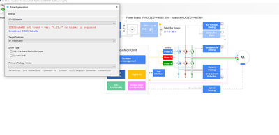

hi,
When I want to generate the code, it says that the STM32CubeMX version is not supported.
Even though I downloaded the latest version, it still gives the same problem.
How can I solve this problem?
Thank you

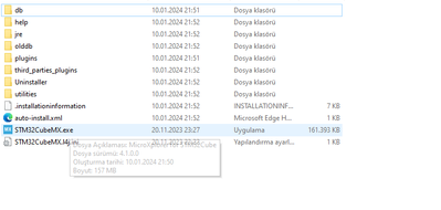

Hi @ENGIN TANRIKULU ,
Please provide more information about your installation to help us to replicate the issue:
* CubeMx versions installed
* CubeMx installed for "user" or for "all users" (system installation)
* CubeMx installation folder was manually moved?
* OS used and version
* OS Language
Regards
Claudio

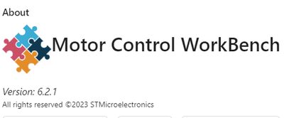

Hello ENGIN TANRIKULU,
It looks like it is your MCSDK version that is outdated. You can either download the MCSDK latest version MCSDK v6.1.2 (recommended solution) or downgrade your CubeMX version to one that is supported by the MCSDK you are currently using. Unfortunately, as I don't know which version of the MCSDK software your are using, I can't give you any more precise information.
Hope this will help,
Gaël A.

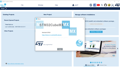

Hello @ENGIN TANRIKULU ,
I highly encourage you to switch to the latest MCSDK 6.2.1 version.
If you are forced to stay on a 5.4 version, the supported version of cubeMX at the release date was STM32CubeMx 6.4.0.
Regards
Cedric

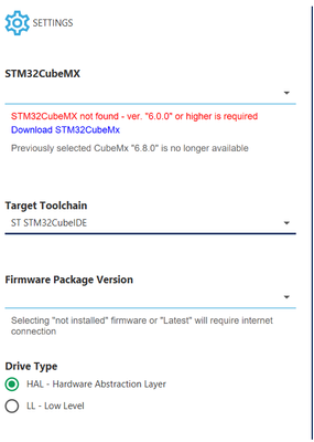

‎2024-01-18 5:45 AM
I'm still having the same problem.

‎2024-01-19 4:18 AM - edited ‎2024-01-20 3:51 AM
Hi @CLD ,
Operating System Language: Turkish
The problem took some effort, but it turned out to be caused by the operating system language.
