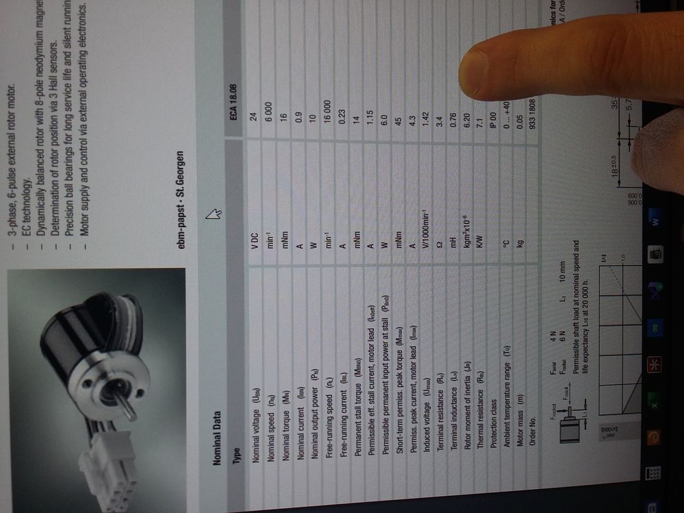

After getting the data sheet for my motor the motor is nearly spinning it is so close.

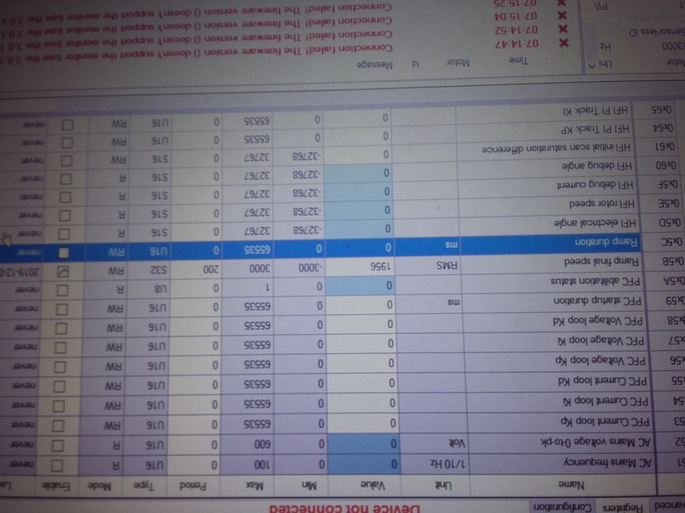

I set the speed voltage with pot and press run the motor attempts and starts spinning several times then stops saying speed feedback error on the motor workbench GUI
I look through all the paramaters and one looks suspiscous
paramater 0x5C ramp duration is set to 0mS I can not find the paramter for ramp duration in any of the header files
Where is the ramp paramater

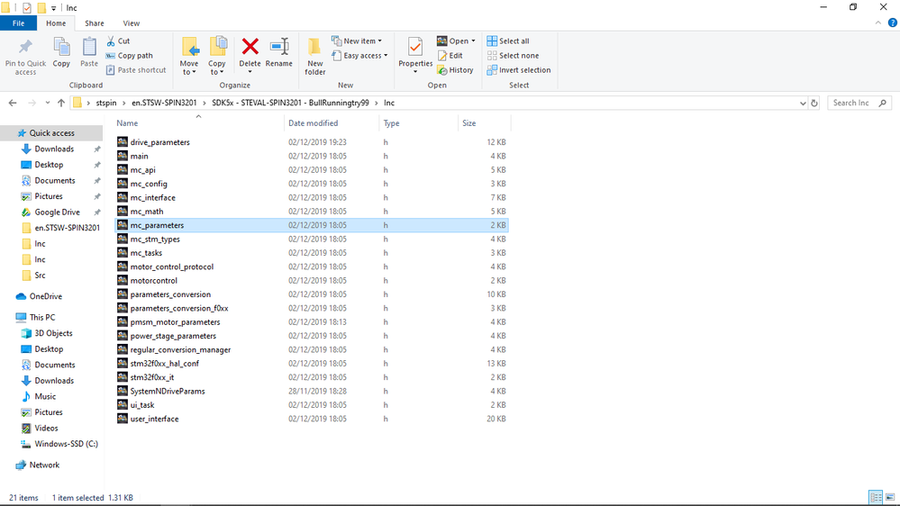

out of all these files shown in the picture which one contains the ramp speed parameter I think because par mater reg 0x5C is set to zero so theres no ramp time and it dosent start
heres the file list
please can anyone suggest which paramater i need to change the motor spins several times over a half second then stops im so close any help wouldbe much appriciated.
