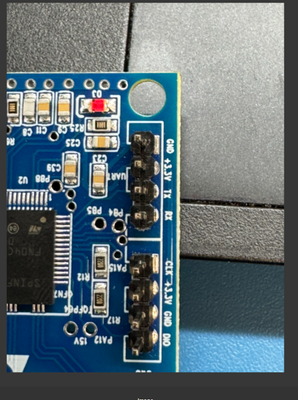

I am using multiple ST Evaluation Boards and all worked well . However , in one of the board i am facing issue of UART connection . Board is ST
EVAL-CTM012V1A . STMCSDK is 6.3.2, Keil u vision 5 , STM32cube Mx 6.11.1 . Baud rate tried :- 9600,115200,19200,1843200 . . However board is running fine in debug mode . Please help me in solving this issue

Hi Cedric ,
Debug mode means running fine with IDE .
Got this issue rectified as on board Tx and Rx labelled in reverse.
When i connected Tx of USB to ttl to TX of board and Rx to RX of board , connection build .
Thanks for your support and reply.

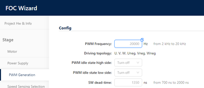

But one more issue occurs  that is connection lost when motor runs . That may be due to interference of magnetic field when motor start running  . If you have any idea to resolve this , it would be helpful for me . Please share .
Hi
The only idea is to configure the UART RX pin with internal pull-up, it could help but it is not guarantee. reducing the baudrate will make the data wider and could also help.

Hello @IC5151,
Did you resolve your issue?
Regarding the connection loss when the motor is spinning, it might occur if the MCU is under high load. Using a lower PWM frequency might help.

i tried reducing the baud rate still it didnt help .
Hello @IC5151,
Decreasing PWM frequency:
If you agree with the answer, please accept it by clicking on 'Accept as solution'.
