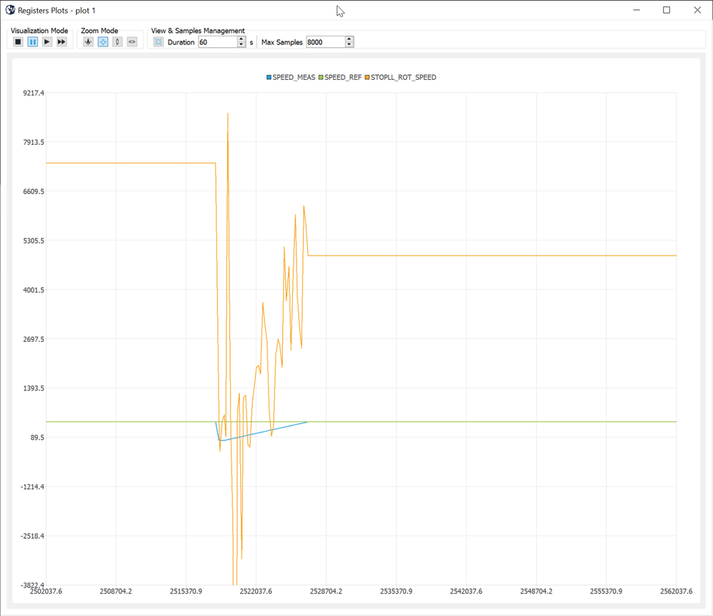

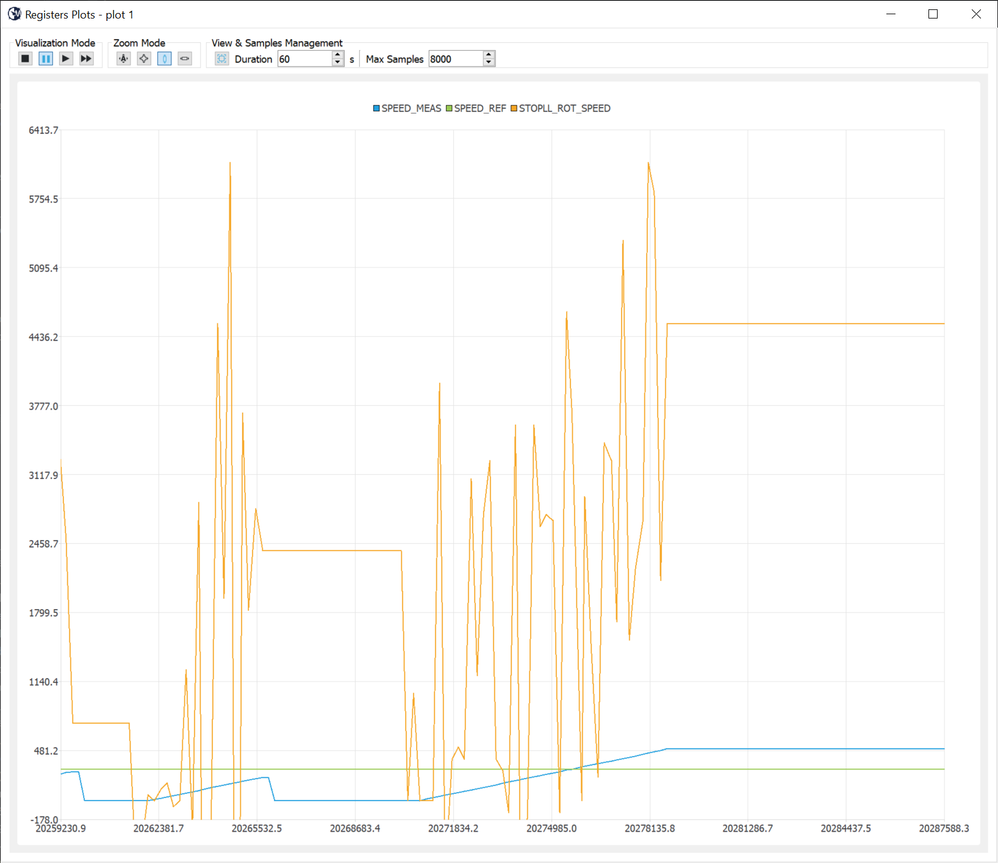

0693W00000QKDiKQAX.pngOk, I'm really confused. I tried to get my other motor to work, its def the observer that's the issue because the estimated speed was ALL OVER THE PLACE. I put the bull runner back in there, and it was more sane. However after putting the bull runner back on with all the default values. It no longer converges and get a speed feedback error. I tried going back to 25000 khz, it didn't help.

After much playing with workbench and using git to track changes. I've understood some of the issues I had with frequency. I neglected to adjust some of my gains when I adjusted the pwm freq. However, this hasn't helped me with my motor. The speed reference is still all over the place if not "better".
Currently my gains are:
C1: 6000
C2: 15000
KP: 8000
KI: 2000
I've moved these around these spots a bit without much better results. I'm quite at a loss.
Is there a way to force it to converge or at the least keep it in open loop for testing?

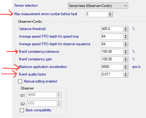

hey, I am experiencing a similar problem and I can share some things that might help you: the PWM frequency has huge impact on the automatically calculated PI values of the current / torque and speed regulators and also on the C1 and C2 values of CORDIC (also PLL regulator values). You could try to increase the values of variance threshold under workbench --> speed sense to max 400% for CORDIC, you could also try to increase the values marked in the screenshot

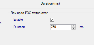

0693W00000QKTKTQA5.pngand you could enable the following checkbox:
0693W00000QKTKnQAP.png under "startup" settings. this helps when you startup the motor without any load, because in this case the acceleration during switchover can be very large and cause speed feedback error. also you could increase maximum allowed acceleration value under CORDIC settings. or increase any of the values in here under startup settings:

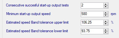

0693W00000QKTLvQAP.pngthe allowed tolerance can be increased, or increase the minimum output speed, so that the switchover happens at higher RPM when the back EMF is stronger and the position estimation is more accurate.

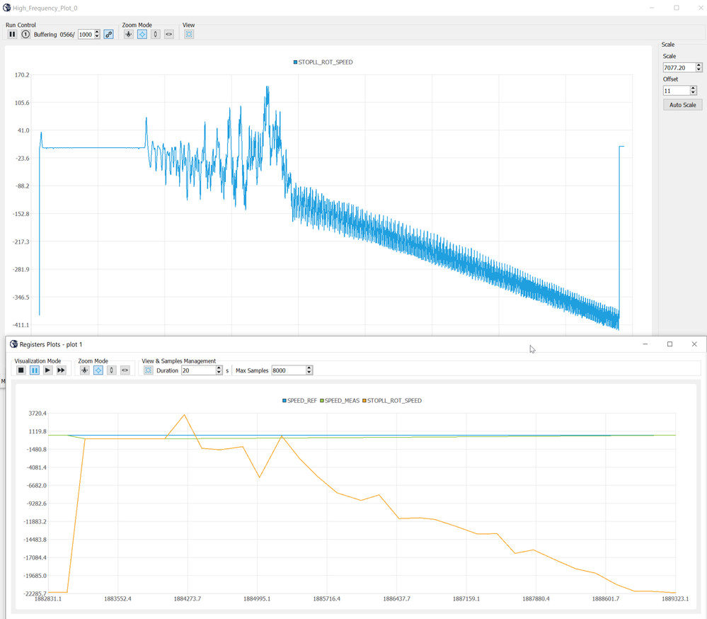

I found that my pole pairs was wrong! I was using POLES not POLE PAIRS. Lots of things are working better now. However, I am getting a negative rotational speed. changing the sign of C1 (-8374 wb gen) makes it fail completely.
Still messing with this, but really curious how to adjust this. I have tried swapping poles of the motor wondering if that would help, it did not.
This motor has a lot of inertia, but the motor is overpowered... I've been thinking its my startup profile, it tends to get almost to my final rpm then faults. like its lagging to far behind. I have adjusted the lower and upper limits, hasn't really helped me much. CORDIC didn't work at all for me, PLL seems to estimate better (if not opposite sign).

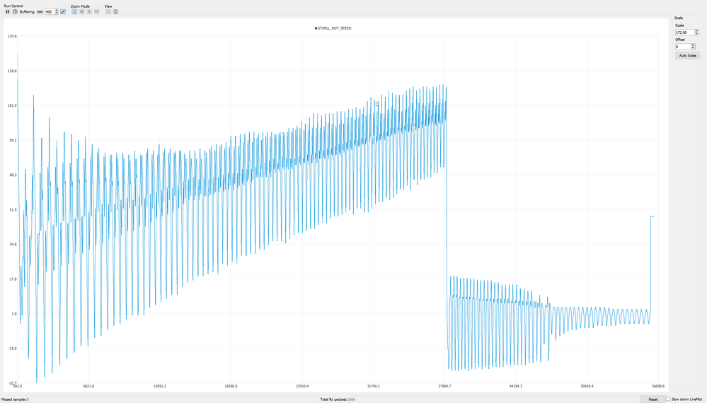

Also something weird, the high speed plot Y axis and the Polled plot y axis of the same value are different. Plotting both shows the discrepancy. 0693W00000QL0SpQAL.png

More info.
I have gotten it to go positive, but its really touchy. sometimes it will go positive, others it wont.

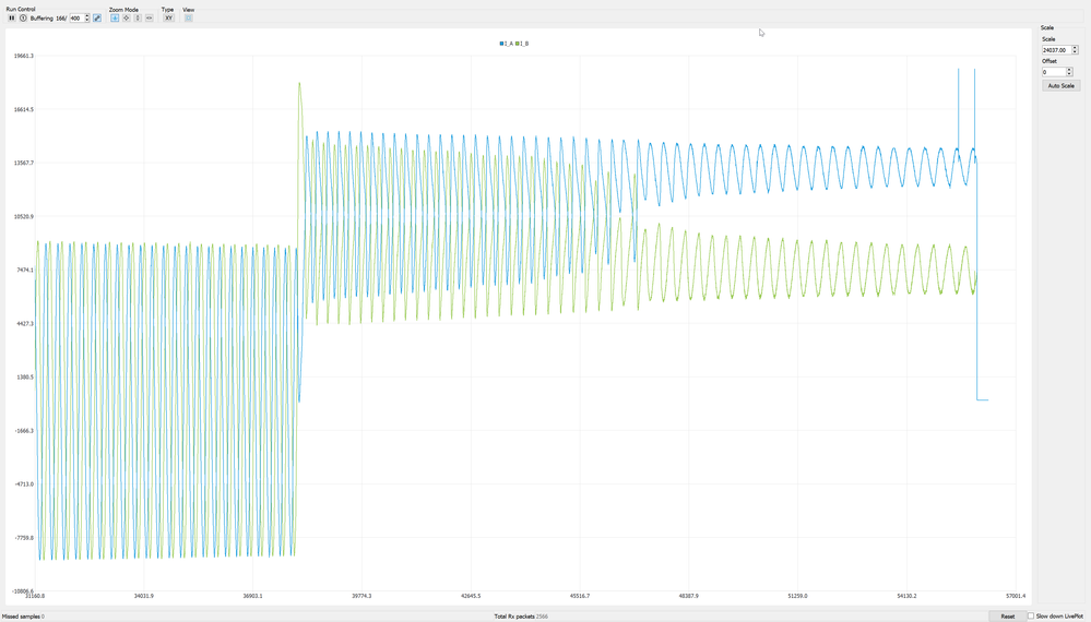

I have been slowly reducing C2/GAIN2 to get somewhat reliable feedback. however, whenever it tries to switch over, I get weird current profile. Matches roughly what I see on the sillyscope.
I'm trying to play with the torque gains, only thing i can think of that would have such a drastic change on the pwm... But still why would it screw up this bad... Any insights would be greatly appreciated...
Current settings:
Torque: P = 3712, I = 2000
PLL: C1 = -8374, C2 = 14978, P = 598, I = 26
C2 is very sesitive at any #... I took it down to 7500, and just one number higher or lower will make it not work. but decrement a few more and it will work again.
