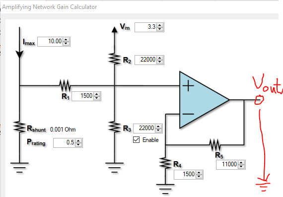

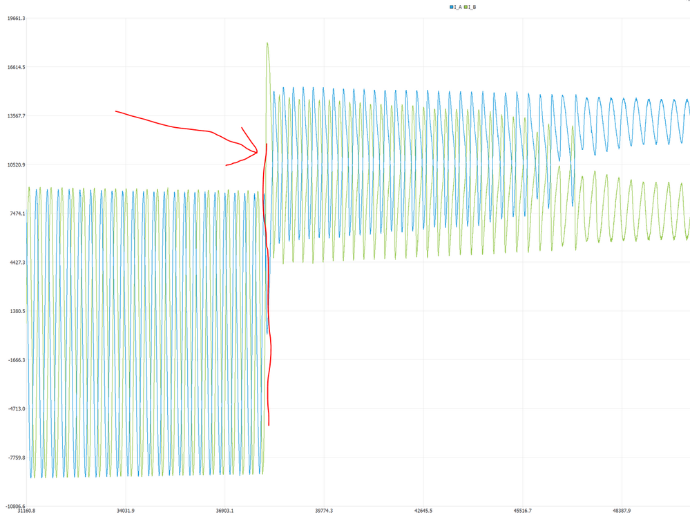

do your currents I_A and I_B still look like this? 0693W00000QLIiHQAX.png and did you press "stop motor" at this point where the red line is or did the graph experience this shift on its own? It looks to me like the voltage of the OPAMP output of your current sense is experiencing shifts. check if one of the voltage divider resistors has bad soldering. try measuring the output voltage V_OUT of the two OPAMPs 0693W00000QLIivQAH.png and check if the resistors R2, R3 , R4, R5 are all good and have reliable contact to the PCB

It actually did that. That was when it tried to close the loop.
I fixed that by reducing my torque kP values.

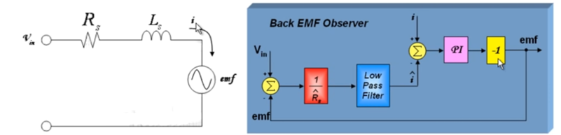

did you check the output voltage of the opamps for consistency? a speed feedback error can have a dozen reasons, when the sensorless algorithm/observer is not able to correctly assume speed, as it can be seen from the scope above (estimated speed is experiencing shifts) this could be caused by bad current sensing since the observer is using an electrical model of your motor to estimate the expected back EMF, and current is one of the input parameters of the model. 0693W00000QLIwiQAH.png as you can see, the obeserver needs accurate current reading to reconstruct the BEMF correctly. So first I would check if my current sensing is working, do this by checking the output voltage of the OPAMPs and the resistor of the actual soldered component on your PCB (not in the software)

Well, the demo motor that came with the IHM07 kit works default settings (basically after running the profiler) But this motor the profiler won't profile and default settings def don't work. The current looks great if you see it on the scope, very little noise. When i see it try to close the loop i do see all of the phases just kinda go wonky like that plot.
Yes i have become very intimate with the observer, i have been digging into the code to see what i can do. Considering another motor works fine, I don't think its the driver.
Perhaps my driver will work better (we have custom boards coming) since the current sense is done a little different, maybe less noisy? But i don't see any noise.
