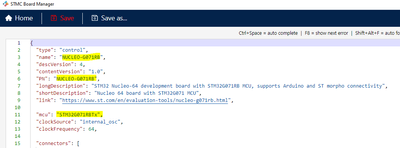

How can I change the MCU to STM32G030K6T6? the tool only shows me the eval boards, and if I choose for example a near enough devkit like  stm32g071 eval board, I can not change the MCU later in the tools.
Regards
Hi Cedric
Could you please help me on how to change the MCU to STM32G030K6T6? it seems it's impossible or I'm doing something ***.
Thanks

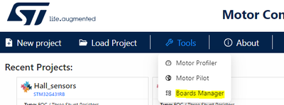

cedric H
In your project, you use NUCLEO-G071RB .
You must start with the board manager :
Clone your NUCLEO-G071RB board
Change the name of the board and the PN (basically put the same name on both)
And most important, replace here the mcu by the one you want. It must be part of the mcu folder under Utilities\PC_Software\STMCWB\assets\hardware\mcu
Last point, check that all the MCU pins described in the board description are present and properly named ( pin name reference is your mcu json file).
Once saved without error, your new control board will be part of the control board list and you will be able to use it into your new project. If it is not the case, please attach your new board description to this thread (it was actually my question in my previous answer)
Hope it helps.
Cedric

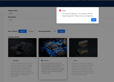

Hi Cedric
Thanks for the feedback, Now I have tried to modify a cloned JSON file for the STM32G030K6Tx part as an inverter, But the tools does not allow me to generate projects, it would says hardware is not compatible with the algorithm, please check my attached JSON file,
I hope you could find the bug.

The board you have chosen(based on  NUCLEO-G071RB)is not compatible with 6-Step algorithm ,meaning that the proper hardware for driving motor in 6-step algorithm doesn't exist on the board(Hall sensors or BEMF feedbacks)
Choosing FOC as your algorithm would probably solve the issue.
Regards.
