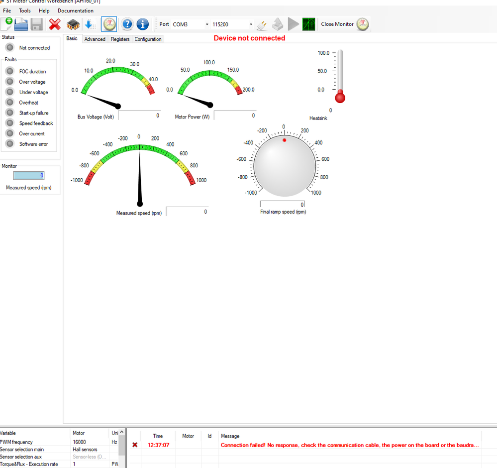

I used STSPIN32F0A as my motor control chip, the X_CUBE_MC workbench version is 5.4.4 , and the firmware package version is ST32 FW v1.11.2, then I generate the code ,but when I connect the MC workbench , I couldn't connect the MC workbench serial , and gave the below fault , This problem has been bothering me for a long time,Thank you very much for helping me

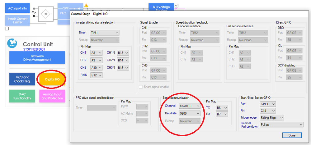

I suggest to check the communication speed set into the FW configuration and if it is correspond to the one in the monitor (baudrate 9600):
Let me know if it is helpful.

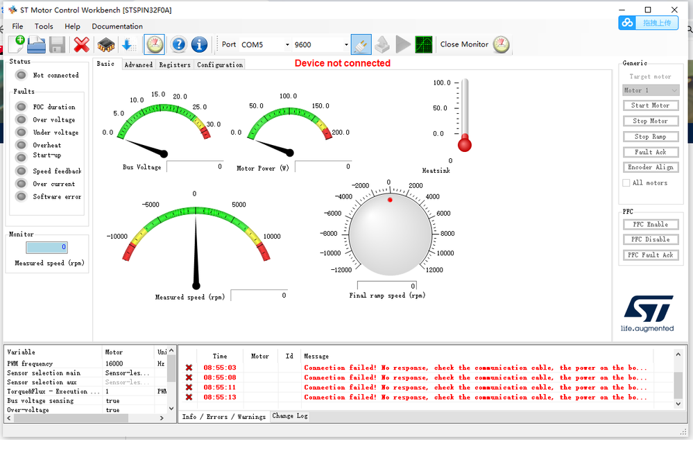

2021-02-16 1:08 AM
Hi Cristiana. Thanks for your answer! I have checked the connection and the baudrate , they were ok. When I debugged the first time it could connect, but after changed the parameters of the current sensing , the serail communication was lost !
