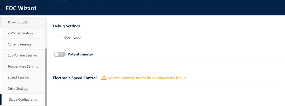

how we can change the speed of motor in STEVAL -SPIN3201 using external Potentionmeter?/or inbuilt Potentionmeter (Variable resistor )?

‎2023-07-19 12:00 AM
Hello Ranjeet Singh,
Using the MCSDK 6.1.2, you can enable the potentiometer while configuring your project via WorkBench.
Under Stage Configuration, check the Potentiometer box :
The generated project should include a speed control using the board's potentiometer.

‎2023-07-19 4:45 AM
how to solve this in old software 5.4.7 ?
‎2023-07-20 12:14 AM
Unfortunately, the potentiometer feature was not available in MCSDK 5.4.7 and was introduced in version 6.0.
However, you can still implement it yourself with a bit of coding.
Hope this will help,
Gaël A.

‎2023-08-07 12:13 AM
In my opinion, the easiest way to do it is to generate two projects using MCSDK 6.1.2 : one with potentiometer enabled and the other without, and see what the differences are so you can copy the potentiometer related part of the code to your 5.4.7 project.
