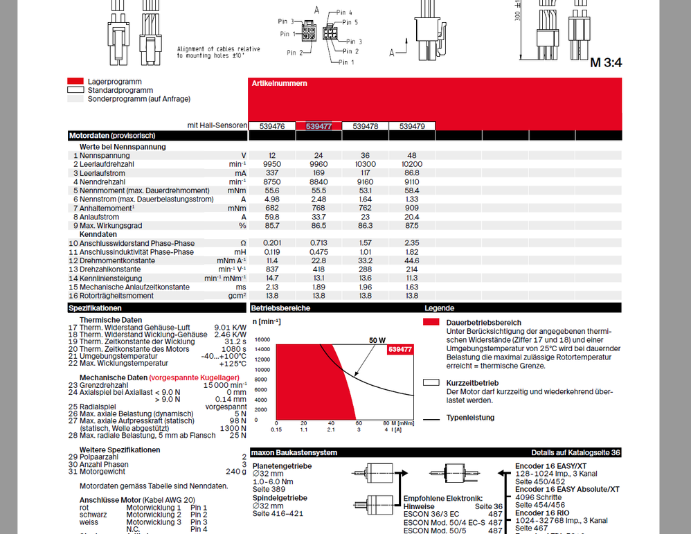

Motor: Maxon EC i 30 , Art. No 539477 (24V , 2 pole pairs, Hall Sensors)

Here is a screenshot from the motor data sheet.

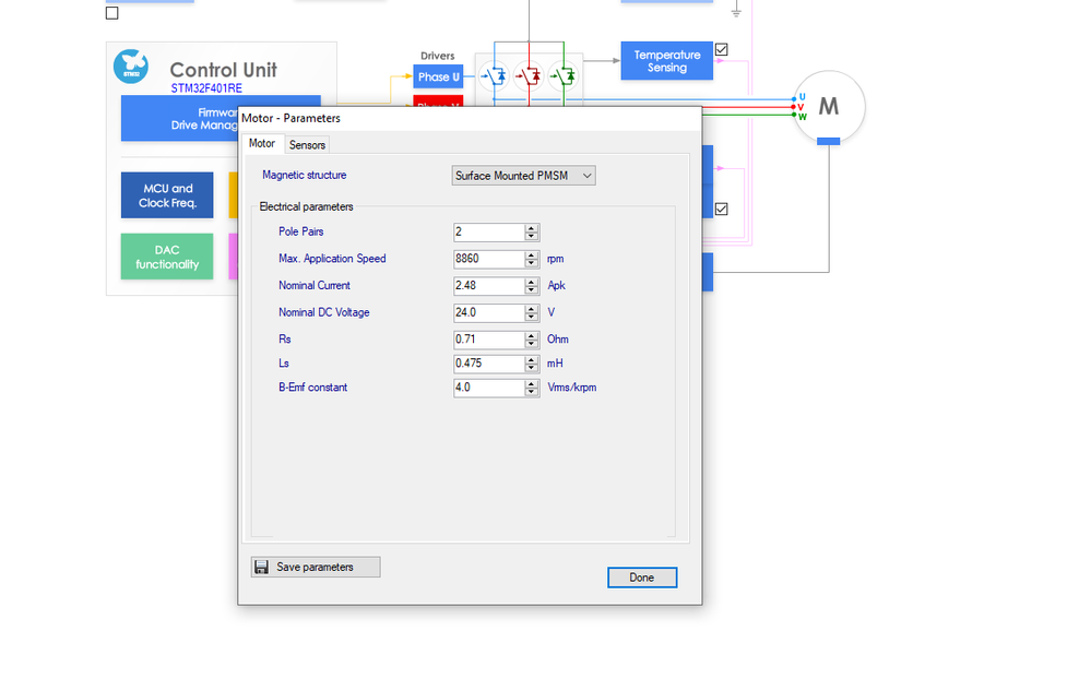

Parameters workbench:

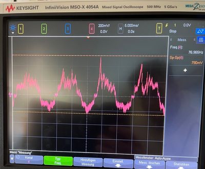

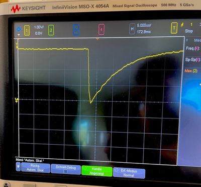

I have two different projects. One for each power board. When using the IHM08 power board, I observed short peaks in the input current, reaching up to 3.5 A(You can see it in the picture below). I have also a voltage drop at the DIA/EN Input of the IC L6230PD, which is used for the board IHM07.
But this signal is never used in the code for the board.
Voltage drop of the DIA/EN Signal measured at PIN CN10/13
Input current for the motor. 100mV = 1 A(Board IHM 07)
Input current for the motor. 100mV = 1 A(Board IHM 08)
