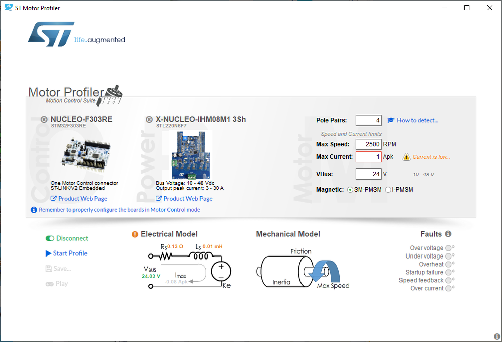

The motor profiler never worked for me, I changed the current, the max speed, but I could never make the motor turn and received after a while the message that "it is taking too long".
The IHM08 is a little bit oversized for your motor and the accuracy of the small current read by the shunt may not be good enough. After reading your post, we tried to reproduce your issue with a motor in the same range of voltage and power as yours. Shinano LA052
We succeed to profile it after several trials with a Max Speed set at 2500rpm (instead of 4000rpm by default) and a Max current Apk=1A.

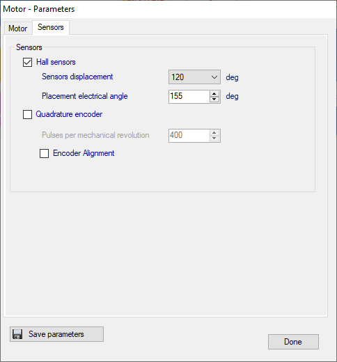

I changed the "placement electrical angle" in the Hall sensor configuration from 120° to 190° and tested if the motor was starting in the CW and CCW directions, at 155° I obtained the best results that I mentioned earlier, I can slow the motor down to 160-170 RPM in both directions, below that the motor stops.

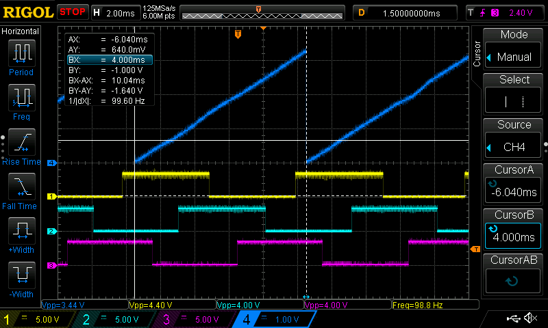

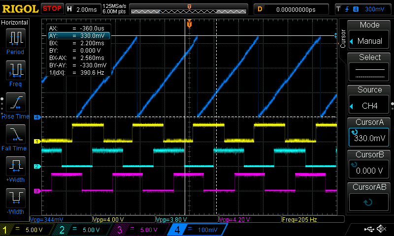

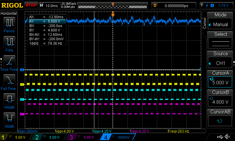

The signal from my Hall Sensors looks ok, there is noise present but it doen't look very dramatic, since yesterday, I'm able to use the DAC output to debug, here a screenshot of the three hall sensor (Yellow - H1, Cyan - H2, Magenta - H3, Blue - Measured electrical angle).
As you mention at the beginning of your post, the measured currents (Ia, Ib ... ) are quite small, hence it may be difficult to improve the motor performance, reduce the rotation speed. what do you think ?

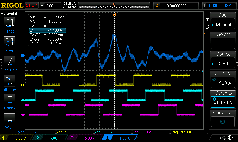

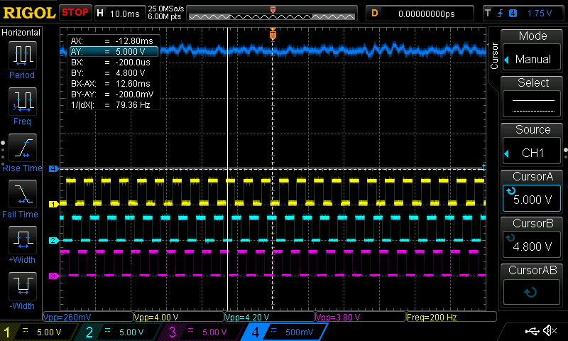

Checking the "use MTPA" option on the "Main sensor" tab, this is how my plot looks like, I got also a current probe and this is how my current look on the Phase_U
