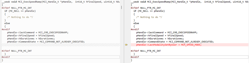

Thank you it runs now after correcting hardware issues, but few concerns is after some rotations for 1 to 2 minutes it gets struck up, sometimes gets problem in starting. Do we have solutions for that?
SRedd.5
Senior III
Now I have landed in confusion when you give the last command Mci_execSpeedRamp it does not stay in open loop mode it goes to speed mode, could you please explain me this?​
It is my mistake
