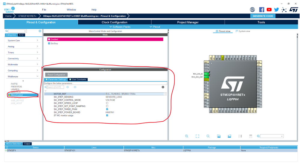

Hi All,
Does anyone know how to add the Motor Control library using STM32CubeIDE or STM32CubeMX as shown below figure? Is it possible in the first place?
By the way, the figure is the output result of Motor Control Workbench.
As you know, the X-CUBE-MC SDK tools only generate code projects for supported devices and evaluation boards. If you don't have the device you are using, it will take more time in migrate similar example code.
If I can easily add a library, I would like to do it.

I use X-Cube-MCSDK. All project generate by this software, Motor Control Workbench, have motor control setting when open CubeMX project. MCSDK is not user friendly. Its hard to use and implement to any project.
Do you know the way to load the settings and minimal libraries to drive BLDC motor using STM32CubeIDE?
It’s hard to understand the code output by MCSDK. Mostly not work.
So I’m using TI motor control libraries.​

I think there's no easy way to integrate the MC middleware without the MCSDK.
And yes, the code generated by the MCSDK is not very easy to read, but the functionality of a motor control middleware is never easy to read due to it's complexity....
Back to MCSDK: we generated configuration & code for our specific customized hardware. I guess you have to go a little bit deeper into the MCSDK. It's really a good tool.
