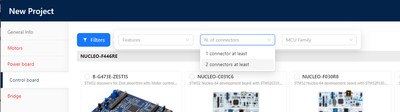

Hello @apexyz,
You can filter control boards that support dual drive by using "Filters" feature (NUCLEO-F446ZE board is not available on current MC Workbench version):

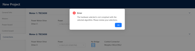

Thanks for the prompt reply! But when I config 2 motors in MC Workbench, I got the following error message:
How to set up the wiring and power handling properly?

Hello @apexyz,
