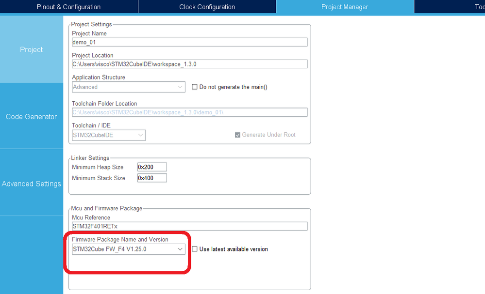

Hi @Laurent Ca...​ , @Karl Hönemann​ , @Community member​ ,
I've done the follow steps.
1) Update the fw package to the last one 1.25.1 inside the ProjectManager0693W0000059YUrQAM.pngTry again but I've the same error
2) Apply the patch called "en.patch_cubef4.zip"
3) Added these lines of code into the "CDC_Control_FS" function inside the "usbd_cdc_if.c" (thanks google).
    case CDC_GET_LINE_CODING:
    	if (length == 7)
    		uint32_t bitrate = 9600;
    		pbuf[0] = (uint8_t)(bitrate);
    		pbuf[1] = (uint8_t)(bitrate >> 8);
    		pbuf[2] = (uint8_t)(bitrate >> 16);
    		pbuf[3] = (uint8_t)(bitrate >> 24);
    		pbuf[4] = 0; // 1 stop bit
    		pbuf[5] = 0; // parity none
    		pbuf[6] = 8; // datatype
    break;
Try again and now it's working !!
I'd like to ask you, in your opinion this is the correct way or is a band-aid solution?
Do you have any other suggestions?
Thank you for your support & your time.
