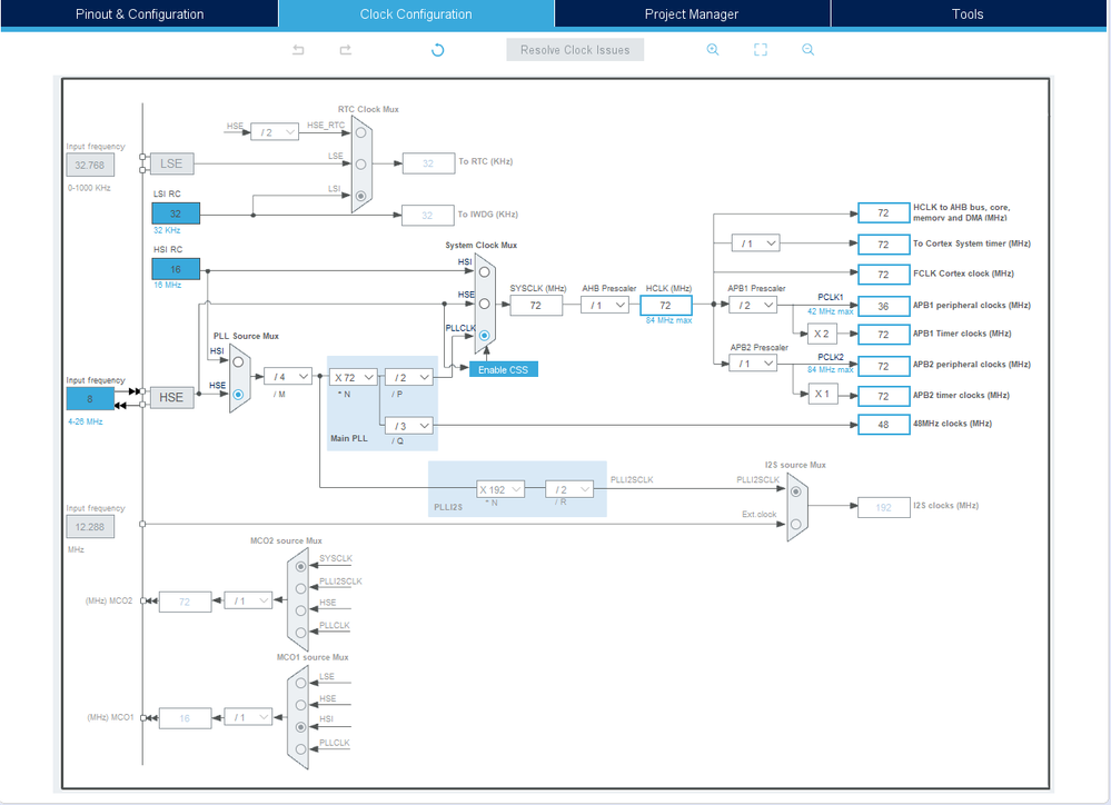

This is my clock config auto generated by STM32CubeIDE
void SystemClock_Config(void)
 __HAL_RCC_PWR_CLK_ENABLE();
 __HAL_PWR_VOLTAGESCALING_CONFIG(PWR_REGULATOR_VOLTAGE_SCALE2);
 RCC_OscInitStruct.OscillatorType = RCC_OSCILLATORTYPE_HSE;
 RCC_OscInitStruct.HSEState = RCC_HSE_ON;
 RCC_OscInitStruct.PLL.PLLSource = RCC_PLLSOURCE_HSE;
 RCC_OscInitStruct.PLL.PLLM = 4;
 RCC_OscInitStruct.PLL.PLLN = 72;
 RCC_OscInitStruct.PLL.PLLP = RCC_PLLP_DIV2;
 RCC_OscInitStruct.PLL.PLLQ = 3;
 Error_Handler();
 RCC_ClkInitStruct.APB1CLKDivider = RCC_HCLK_DIV2;
 RCC_ClkInitStruct.APB2CLKDivider = RCC_HCLK_DIV1;
 if (HAL_RCC_ClockConfig(&RCC_ClkInitStruct, FLASH_LATENCY_2) != HAL_OK)
 Error_Handler();
I've also welded a XTAL 8 Mz + 2 capacitors on my NUCLEO F401RE and cut off the ST-Link debugger.

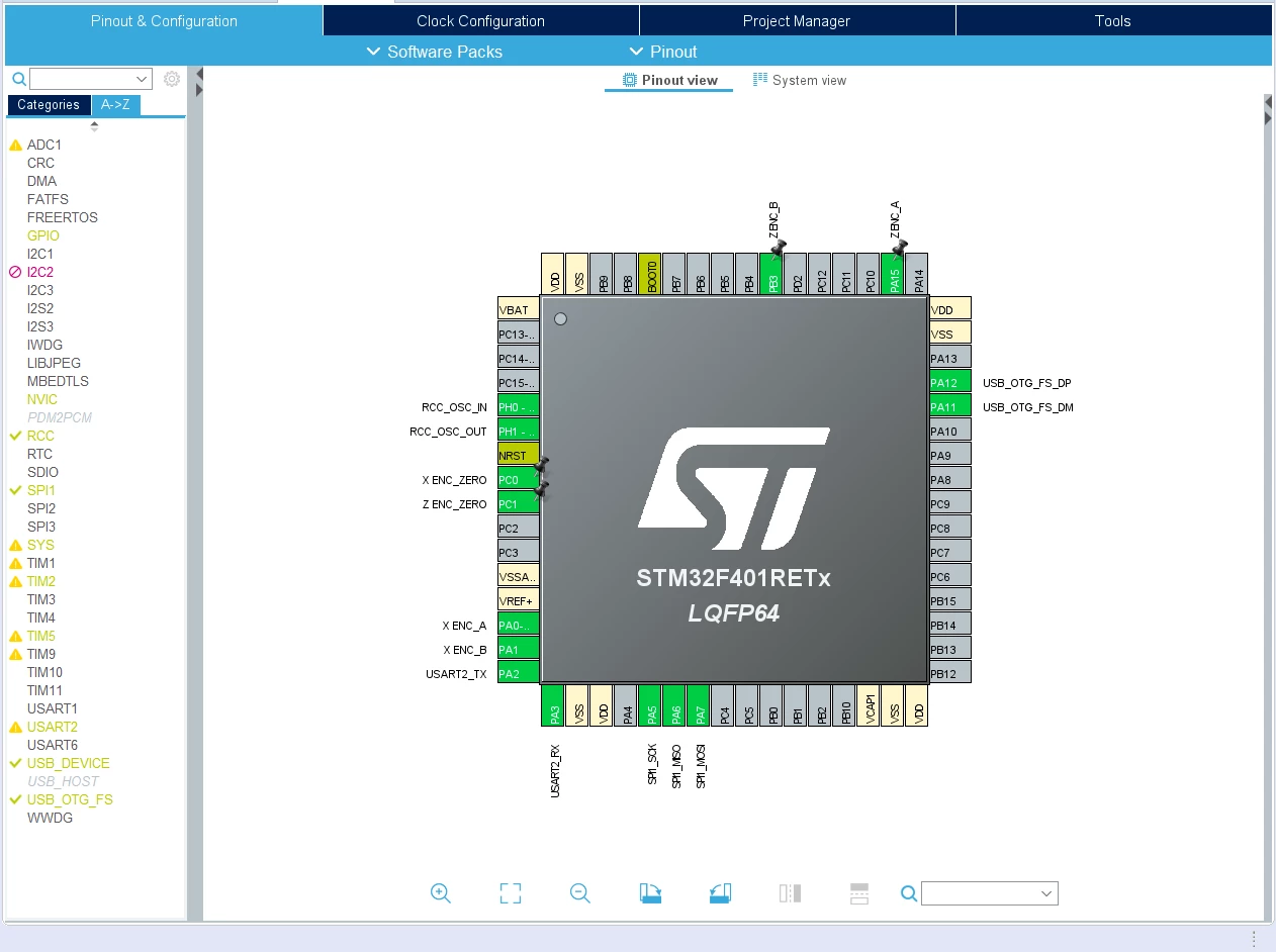

I've done some test to investigate, follow some informations:
OS: Windows 10
Framework: QT 5.14.2 with QSerialPort class to communicate
STM32: PA11, PA12 (you can see on my first picture in the first post)
Board: NUCLEO-STM32F401RE and X-NUCLEO-IHM03A1
I know, seems like a QT problem, but if I download the old firmware, without all the motor section / initializations the communication works fine !!

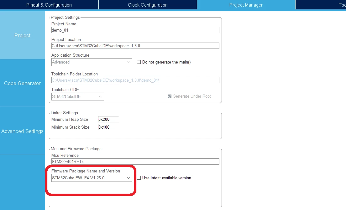

1) Update the fw package to the last one 1.25.1 inside the ProjectManager0693W0000059YUrQAM.pngTry again but I've the same error
2) Apply the patch called "en.patch_cubef4.zip"
