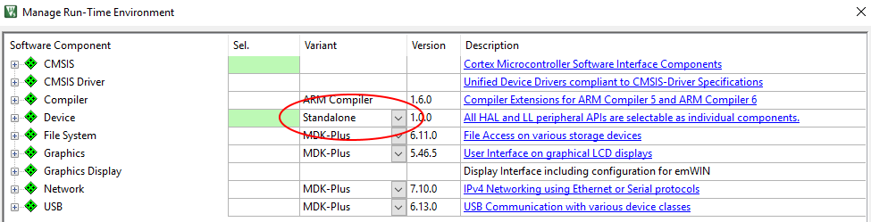

I am using stspin 3202 six step library to run the bldc motor and using steval3203 board and I am facing this error:
.\Objects\Project_Potentiometer.sct(7): error: L6236E: No section matches selector - no section to be FIRST/LAST.
So how to fix this.

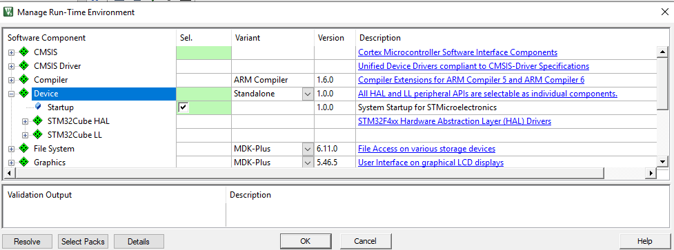

Hello @Ryada.1​ ,
in addition to set the device as "Standalone" in the Run-Time Environment, verify that the "StartUp" option is checked inside "Device".
0693W0000059Ly1QAE.pngThen press Ok in the window and Build the project.
Let me know if this time we fix the error ;)

Hello @Ryada.1​ ,
are you using Keil IDE?
If yes, you have to set the device as "Standalone" in the Run-Time Enviroment (Project->Manage->Run-time Environment) as shown below:
 0693W0000058yftQAA.pngLet me know if you solved the issue, if yes please "select as Best" my answer.
If you feel a post has answered your question, please click "Accept as Solution"
Ryada.1
Thanks sir for replay yes i am using keil
Ryada.1
i did as same you suggested but problem still remain same
Hello @Ryada.1​ ,
Ryada.1
thanks for reply sir problem solved thanks a lot sir
