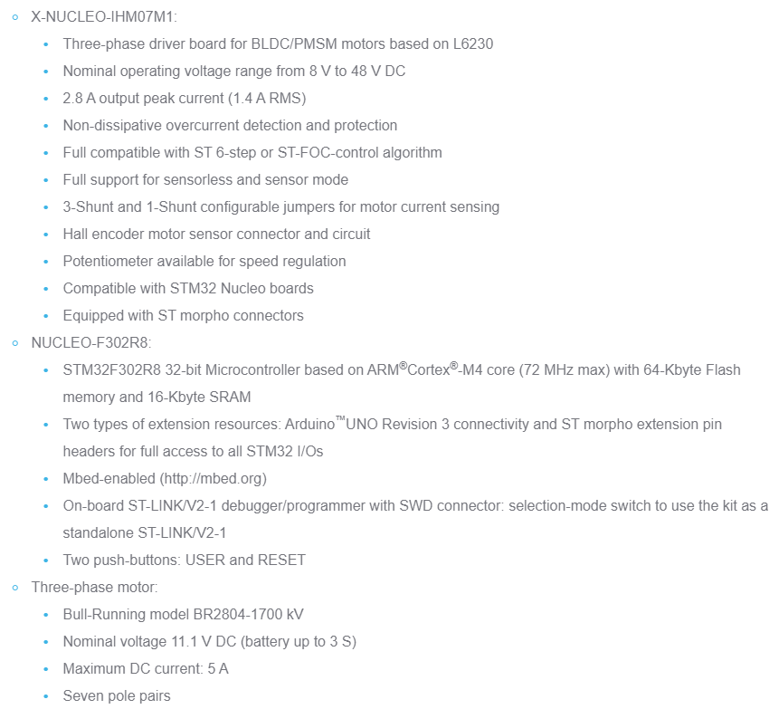

coco.meno
coco.menoAuthor
October 22, 2020
Thanks for your reply. I have the same config of the picture below, it's the P-NUCLEO-IHM001 kit. I'm using "Motor Profiler 5.4.4", "MotorControl Workbench 5.4.4", "STM32CubeMX", "STM32CubeIde 1.4.0".
Best regards,
Coco
