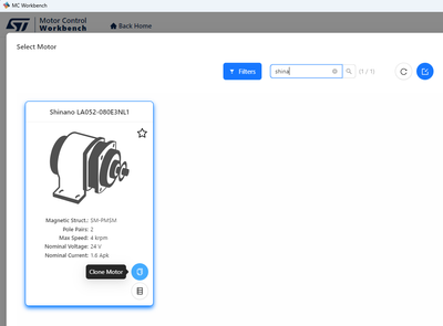

I want to add a custom motor under "New_Project" in MC Workbench. As soon as i am clonign previous motors, i am not able to edit it and the edit window is getting closed automatically.
Please suggest me what i should do.

Using new project on Workbench 6.4.1 and clone motor, it is possible to edit motor parameters.
You can also edit the previous motor .json file (located in ~\.st_workbench\hardware\motor) using a text editor.
