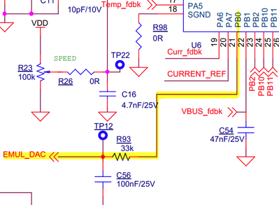

I'm using EVSPIN32G06Q2S1 board.
PB0 is a DAC emulator controlled by PWM duty.
But it’s always disabled. How can I enable it?

Hello @VictorChiou,
Thank you for your report.
Unfortunately, the DAC emulation feature is no longer available on version MCSDK6.x.
This point has been reported to the dedicated team to evaluate the possibility of reintroducing it in future releases.
