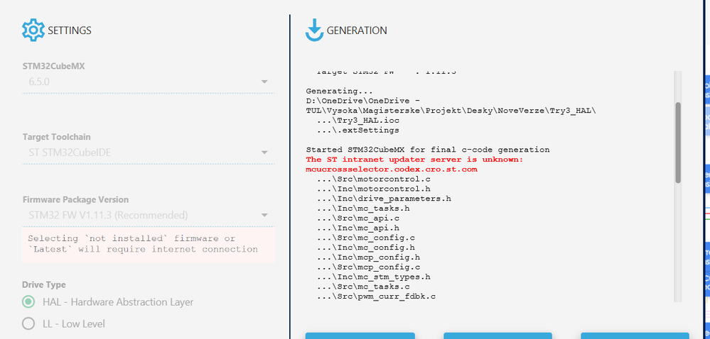

During project generation it show error: The ST intranet updater server is unknown: mcucrosselector.codex.cro.st.com (picture GenerError.png + log Try3_HAL.log)
I tried older version, everything instal on different PC, but without good resolds. I found simulars questions but they didnt help in solving this.

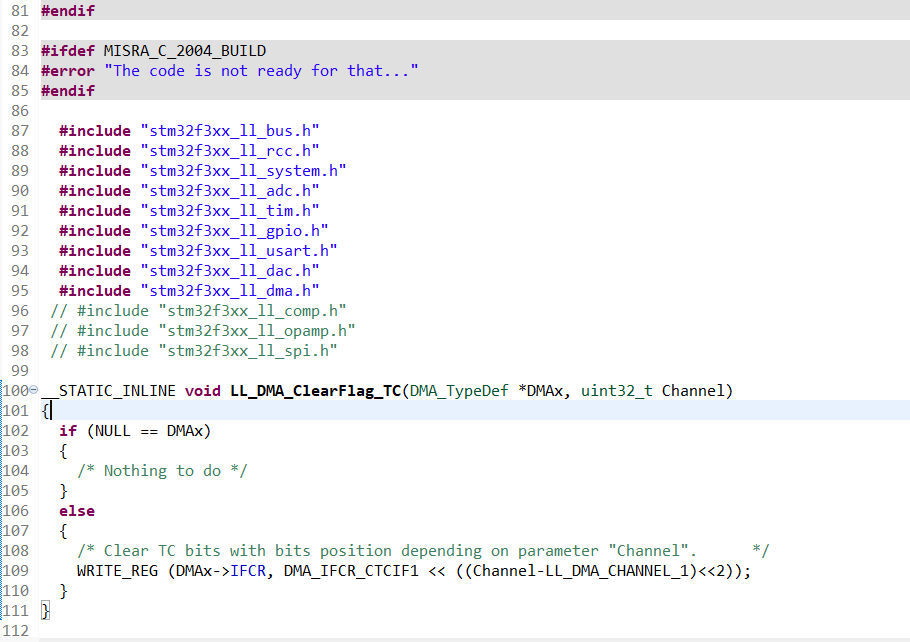

I tried open it in CubeIDE and build the project and it was with errors. Errors were about missing libraries (picture LogNoChangesIDE.png + log LogNoChangesIDE.txt).

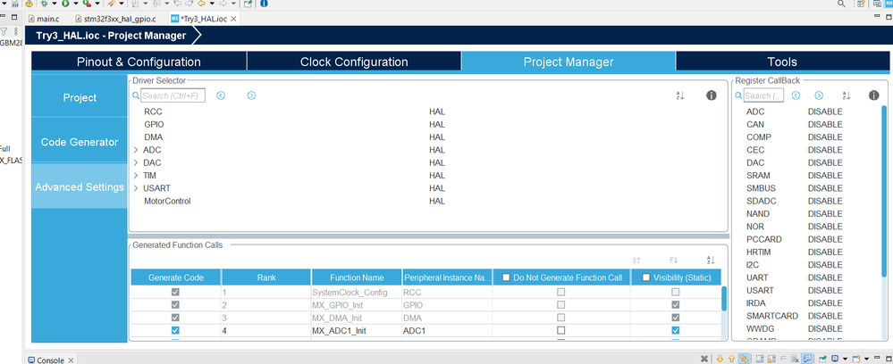

0693W00000Np3LzQAJ.pngI found out even I choose HAL in generation that it want LL or it looks like. When I change in Project Manager - Advanced Settings from HALL to LL (picture LogHalToLLIDE.png + log LogHalToLLIDE.txt) that it can find few libraries.
0693W00000Np3KTQAZ.pngThen I commented others just for experiment (picture + log LogHalToLL+CommentedIDE).
0693W00000Np3N2QAJ.pngAfter this I put missing libraries from project folder to workspace (log LogHalToLL+Commented+LibIDE.txt) than put new missing libraries in workspace (log LogHalToLL+Commented+LibAllIDE.txt).

Hi @jCejka ,
I'm sorry for responding so late. I simply wanted to tell you that the error message you have does not absolutely prevent the correct functioning of the generated code, it is only an error message coming from CubeMx, you can use your firmware without worries.
Regards
If you agree with my answer, please accept it by clicking on "Accept as solution".
